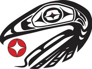

Prior to assembling your necklace, you are going to need to design it. Brilliant! Since the laser cutter takes vector input files you are best off using a vector drawing program such as Adobe Illustrator or Inkscape (free, open source). You'll need some inspiration as well. So arrange for a vision-quest, a transcendent bowel movement, or similar and once you've procured said inspiration begin your design.
Draw your design with manufacturability in mind. Your laser cutter will be unable to produce extremely small wood flecks and you will be unable to manipulate them, so keep your feature sizes reasonable. Typically a minimum feature size of 2mm is good. Also the number of features will dictate how quickly you go insane and give up on the project. Probably less than 20 is a good rule of thumb. If "short attention span" is your middle name, first write your parents a strongly worded letter and then stick to 5 features or less for your design. The pictured design has about 26 pieces depending on how rough you are with the parts which is borderline for a ticket to the rubber room.

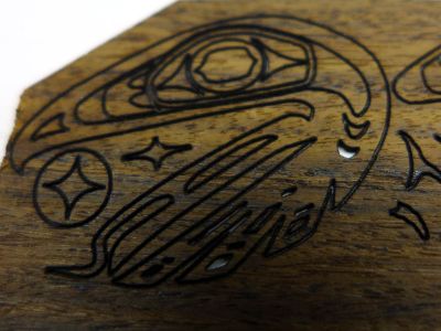

With your design finished, offset for kerf, and prepared for your chosen laser system, the time has come to make some smoke. Take you wood veneer or plastic sheet or lefse or whatever and put it in the laser cutter and burn it. Depending on your material you will need to tune the cutting process (laser power, speed, frequency, etc) to achieve a clean and complete cut. The best setting is the one that cuts the material completely, but just barely. Meaning the lower the power and the faster the speed the better. However, with wood you will find that portions of the veneer piece may be denser or more difficult to cut than others. Having to coax out small fragile veneer pieces that were not completely cut out of the sheet using a scalpel and tweezers is not a fun task. Better to overburn the pieces to be sure that the cuts are complete. Also, due to the very small nature of the parts, you may need to disable any air assist your laser employs. Although a suction system to collect all your precious parts as they fly away into oblivion might be a great invention... (mental note, steal this idea)

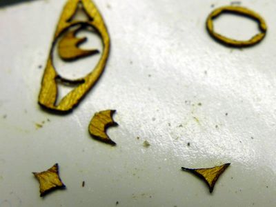

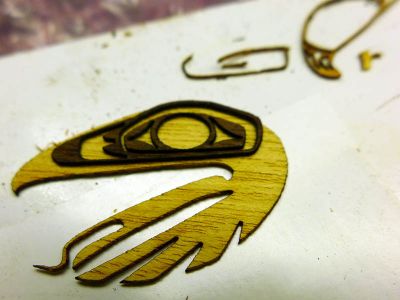

This is where the proverbial chicken crosses the road. No wait, this is where the eggs are all in one basket, or where the bird is in hand.. Ah forget it. This part sucks. You will need to somehow extract the dozens of tiny fragile pieces from your laser system and collect them on a work space suitable for manipulating and assembling them without loosing or crushing them. If you are prone to sneezing or even breathing you may want to reconsider this effort. The slow steady reflexes, endless patience, and cessation of breathing inherent in zombification come in real handy here, so consider it.
The basic idea is to use a tweezers and some wood glue to attach the pieces to your substrate piece. See the pics. You will find yourself undoubtedly with a jumble of half charred and semi-recognizable pieces that you will be wondering where to put. Take a swig of hooch and dive in. You may find it helpful to apply glue to the substrate with a small paintbrush or cotton swab or to dip the small pieces into the glue directly. There are pitfalls to both as you will discover. Try it out and see what works for you. You'll want to glue up one side at a time if you are doing a double sided pendant, and while the glue is drying it will be helpful to press the part between something flat (like inside a book) to keep the pieces in place and prevent warping. Finally a use for that Thomas Friedman book besides leveling your toilet.

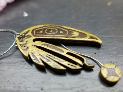

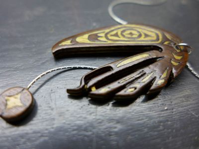

Once you've glued the pendant pieces together to your satisfaction, you'll need to sand off any excess glue and prepare the pendant for finishing. Final sanding should be 320 grit or higher. Then blow any dust present out of the crannies between pieces and wipe the whole enchilada down with a lint free rag and some mineral spirits. Ready to apply a nice finish?
Not so fast.
Forgot to put a hole in the pendant for the chain didn't you? Well it has happened to the best of us. So get out your drill and fine bits and pick a spot on your pendant that looks like a likely place for a hole. Might want to pick a spot where you lost a piece or the glue job is substandard but also consider how the pendant will hang. Drill you hole gently so as to not split the wood or shatter your almost completed pendant and self esteem.
With a hole in place, re-sand, re-clean, and then get ready to apply a finish. You can use a number of finishes. Some people have good success with using super glue (cyanoacrylate) which is supposedly very robust, but it can be a pain to get a smooth surface. We prefer a good quality oil based polyurethane in satin applied by brush. Apply several moderately thick coats, with a little scuff sanding between. Then spray the final coat, potentially touching the shine up with steel wool as needed. Be sure not to full in your hole for the chain. If you do, you'll need to clean it out prior to mounting.
The final step is to apply your pendant to a chain. There are a couple of ways to do that, with a jump ring through your drilled hole (as shown), or threading the chain directly through the hole, or tying your chain in a knot around your pendant, or even gluing your chain into the pendant itself. The best method for you will depend on the type of chain and your pendant design. The presented design uses a jump ring and thin silver chain that is also used to suspend the sun piece. However the chain is glued into the sun piece directly.
