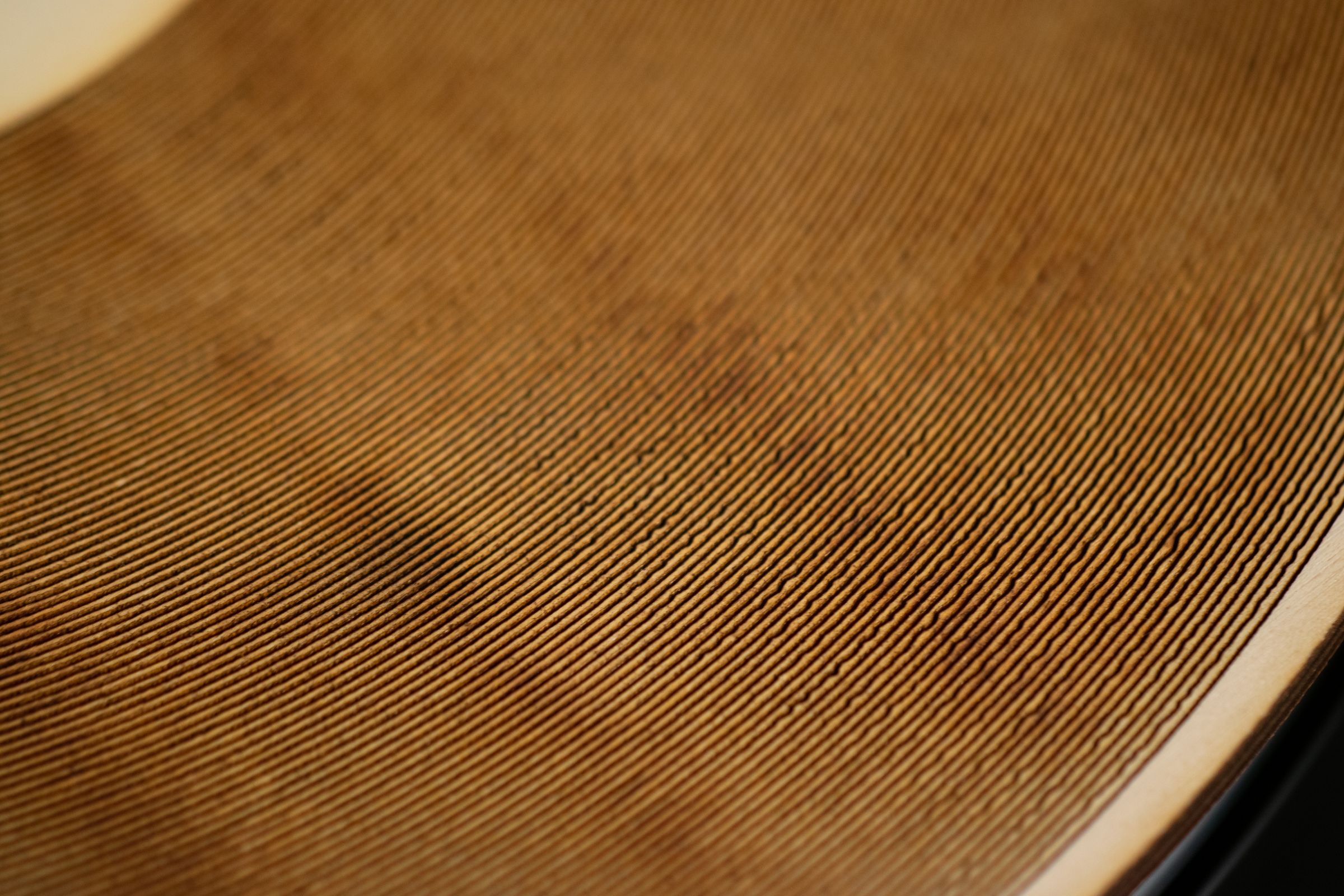

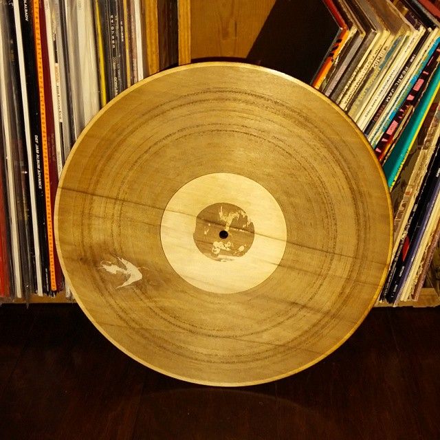

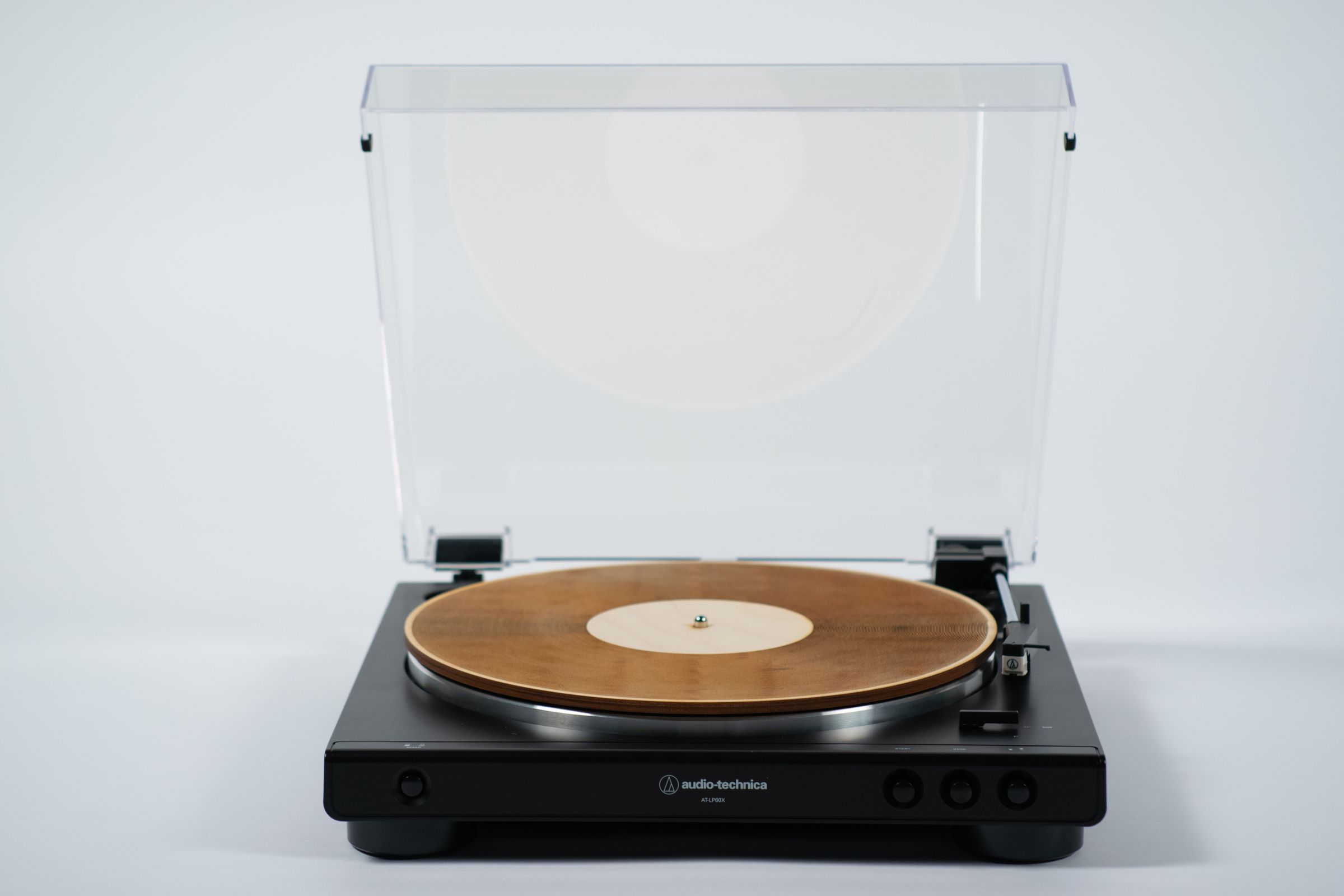

Step 6: Audio Tests on Wood

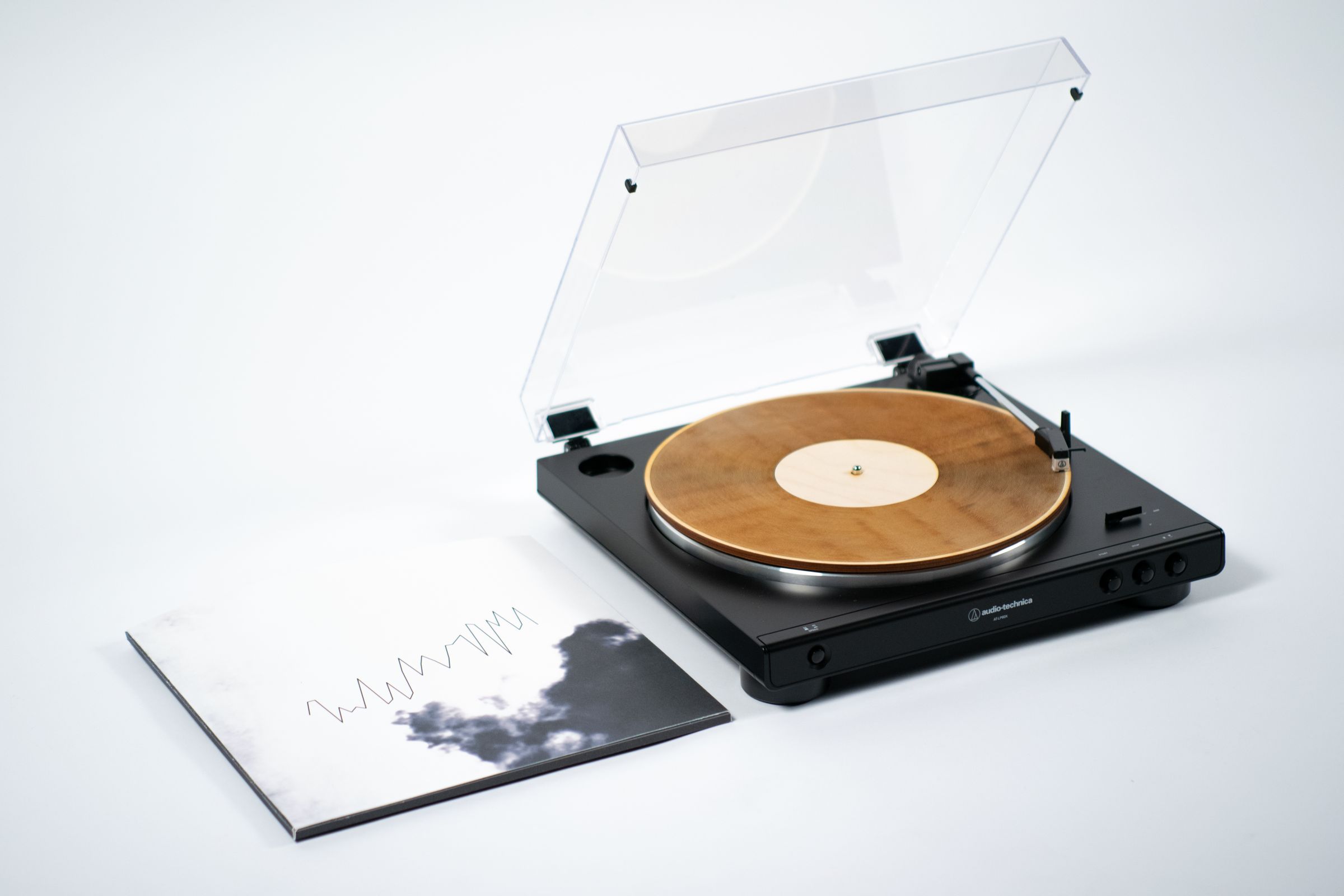

Finally, I cut some records on wood.  Eventually I'd like to cut a record on a 12" wood round with a raw edge, kind of like this, you could cut the grooves right onto the rings of the tree.  For now I have some nice maple sheet to cut, but I did my firsts tests on ply.  I started by using similar settings that I used on the acrylic:
power = 12
speed = 100
freq = 500
amp = 12
This cut looked great, but the needle skipped a lot, I had to hold it in place to shoot this video.  I went back and did some sine wave tests and found that 15 power was more stable, so I ran another audio test at 15 power:
This cut was much more stable, but skipping was still an issue, you can also hear the same tempo issues I was having with the acrylic (I was cutting all these records at the same time).  Next I tested lowering the amplitude of the cut to 10:
I also tried defocusing the laser to widen the groove, keeping the amplitude at 12.  The outer groove is slightly defocused, the inner grove is more heavily defocused:
Both defocusing and lowering the amplitude of the cut helped to minimize skipping, but the defocusing introduced more noise into the audio.  For my final plywood test I lowered the amplitude to 10 and kept the laser focused, I also fixed the tempo issue in my code.  Here is the result:
Unfortunately at this point I was using the last of our plywood stock, so I couldn't be too picky about how flat the ply was, but it still (surprisingly) plays fine(ish).  Here's the code I used:

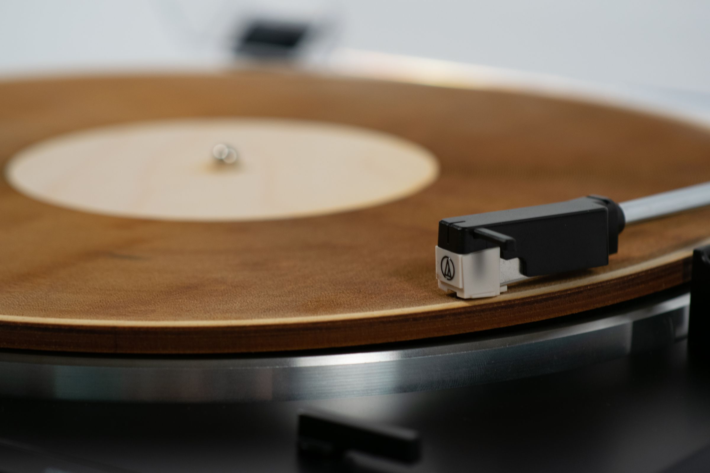

Next I used the maple.  Fortunately, noahw helped me track down a 13" wide curly maple board and cut it into a two flat sheets: one was about the thickness of a real vinyl record at about 1/16" and other a little thicker at 1/8".  I sanded the maple sheets to about 1500grit and finished them before cutting.  I did a few tests on a piece of scrap and found that the power setting I was using on the ply was cutting so deeply into the maple that I would not be able to cut both sides.  I did a few more experiments with defocusing and actually did a full attempt using the song sunday morning by the velvet underground:
In this test I defocused the laser by the width of 11 sheets of normal printer paper.  I used the following laser settings:
power = 4
speed = 100
freq = 500
amp = 10
This cut came out a little noiser than I was hoping.  Since the needle wasn't having any issues staying in the groove, I defocused by only 9 sheets of paper and kept the same power settings.  On the other side of the sunday morning disc, I cut femme fatale:
While I was adjusting some tape to try to keep the wood lying flat in the middle of the cut, I accidentally bumped it to the side slightly.  If you look closely at the video, you'll see where the error is, it caused the needle to skip a groove, but other than that the cut came out great.
This song helped me pin down an error in my code, if you listen closely during the chorus, you'll notice that the backing vocals are missing.  When I looked back at the song, I noticed that the vocals are only found in the left channel of the track, so it seems that I was not combining the two channels before converting to a vector file.  I think I've fixed the problem in my python script, but I'll have to run a test to know for sure.  In the meantime, you can work around this problem by importing your stereo audio into Audacity, right clicking on the track and selecting "split stereo to mono", saving the file as a wav, opening that saved file in Audacity again, copying the track, and right clicking on each of the duplicate tracks to set one to left channel and one to right channel.

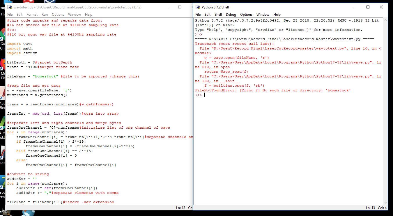

9.  Open the Python file called "wavtotxt".  Copy the file name of the file you just saved in the line:
             fileName = "your_file_name_here.wav"
Hit Run>RunModule, after a minute or two you will have a .txt file saved in the Record Generator folder.

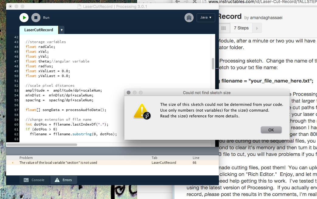

10.  Open the Processing sketch.  Change the name of the import file in the Processing sketch to your txt file name:
             String filename = "your_file_name_here.txt";
Run the Processing sketch Sketch>Run.  The Processing sketch will output several files, none larger than 700KB (I found that larger files were crashing the laser cutter).  The last file will also contain the cut paths for the inner hole and outer edge of the record, you will need to set your laser cutter to cut these lines at a higher power, so that it cuts all the way through the material.  Another very important note about cutting these files - the reason I had to split each song up into five parts is because I found that files larger than 800KB would crash my laser.  When you are cutting out the sequential files, you MUST shut down the laser for a second to clear it's memory and then turn it back on before sending it a new 700KB file to cut, you will have problems if you forget this.

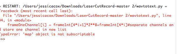

Hey, great instructions. I am having an issue when i run the LinearRecord sketch (and also the LaserCut sketch. It keeps prompting the following:
"When not using the PDE, size() can only be used inside settings().
Remove the size() method from setup(), and add the following:
public void settings() {
size(7200, 360);
IllegalStateException: size() cannot be used here, see https://processing.org/reference/size_.html"
Has anyone else successfully done this recently as I know this article is now a few years old etc.
0
olivieribsb
olivieribsb
Reply 8 months ago
I used the LaserCut sketch this week and It was ok in Processing. Sorry I can't help you more.

Hello to everyone here ! I downloaded the different tracks to make some tests (joy division, radiohead etc) but I can't open them, on inkscape or on illustrator it seems to not work, and I feel frustrated about it ! Has someone had the same problem I did ? Did you find a solution ? :)

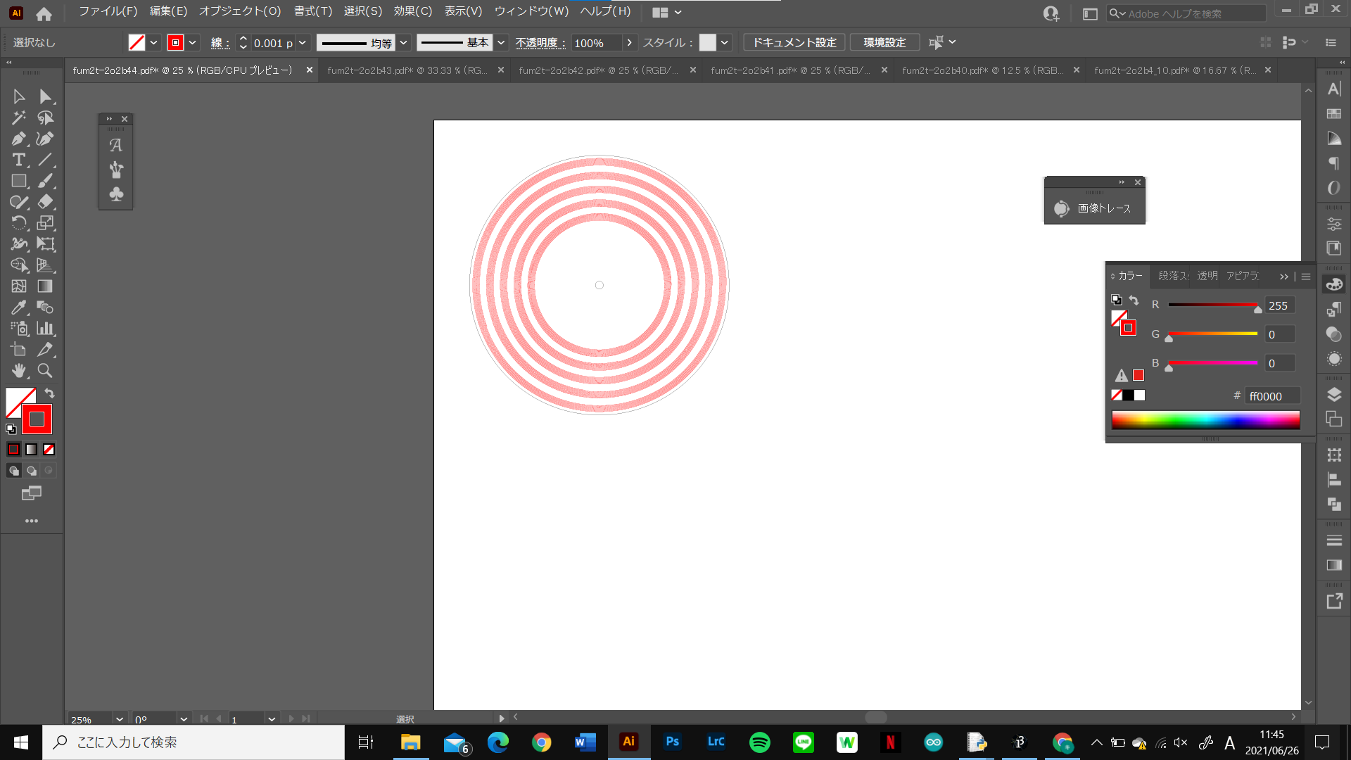

simone.mastroianni.04
Question 3 years ago
Hi, your program works, but my CNC machine reads only image files, not pdf. What can I do? Online converters aren't good Idea.
Can you help me please? Thanks :)

Hey Amanda, thank you so much for this documentation! I used your method in a (climate change) data visualization project for school. The record turned out FANTASTIC. I ended up cutting a song I wrote using the data, and without your thorough documentation would never have achieved the result I did.
- Kyle
Miron_Kyle_Photo_8.jpgMiron_Kyle_Photo_7.jpgMiron_Kyle_Photo_6.jpgMiron_Kyle_Photo_5.jpgMiron_Kyle_Photo_4.jpg

Love this project. Like someone else I'm getting this error in Python--
TypeError: 'map' object is not subscriptable
But I can't find the solution. Could someone help?
UPDATED: That problem was solved by using an older version of Python. Similarly, an older version of Processing was required. However, Processing only outputs a

Hylian_Os
Hylian_Os
Question 2 years ago
Hi Amanda,
I'm trying to use the code to convert the mp3 to an svg, but it keeps telling me that the file i've named doesn't exist, even though it does, is there something wrong?
Thanks in advance

audreyobscura
audreyobscura
Answer 2 years ago
Have you tried adding a .wav file extension to your file name? It may just need the extension.

Hi Amanda,
I've already got the SVG files and arrive at the final step! But when I doing the laser cutting, I found I have to set the stroke to 1pt for our laser cutter ROASTING, when I doing the 0.0001pt, it will cut off the arylic and wood piece. Do you think 1pt will also work for record player?
Thank you so much for your last reply!
0
JamieT10
JamieT10
Reply 2 years ago
Use 0.25 pt or 0.001 inch or hairline. It depends on your laser cutter. I printed from Illustrator and sent it to my ULS laser cutter. The size isn't the actual size of the groove you are cutting. It's simply what your laser recognizes as a vector line rather than a raster.
- Jamie
