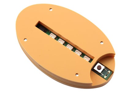

Step 1: The Base
- Download our DXF, which contains the design and the Base which fits the new RGB USB LED Strip.
- Cut out the Base from your choice of Acrylic. We have used Orange Fizz Sweet Pastels Perspex® but you can use any colour you want. Use the screws, and encase the RGB LED Strip in the base.

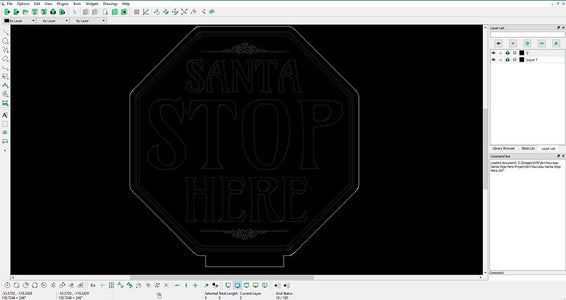

Step 2: The Laser Cut Edge-Lit Sign - DXF
Grab the DXF and either load it straight into your laser cutter software. or If you want to personalise it, you can load the design into your CAD program of choice and tweak it to taste (pictured above is LibreCAD).

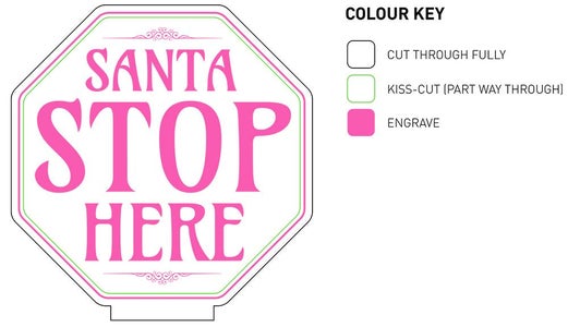

Step 3: To the Laser Cutter
Following the guide above, pop some 5mm clear acrylic on your laser cutter and cut as shown. There are three different types of cut in the design; cut all of the way through, engraving and kiss cut.

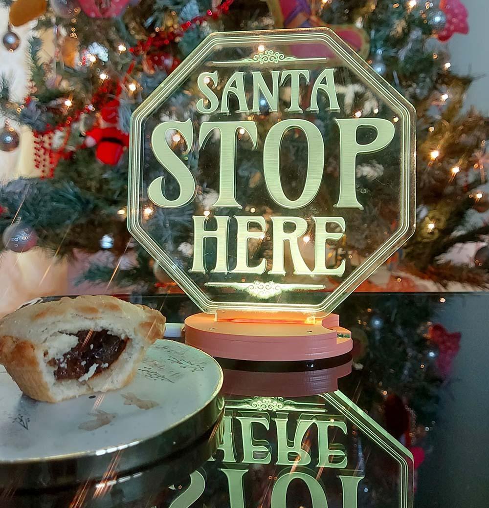

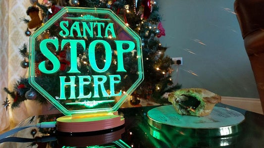

Step 4: Final Step
Introduce the base to the edge-lit sign, plug the strip into a suitable power source and you're done. You should now have something that resembles the sign above, mince pies not included.
