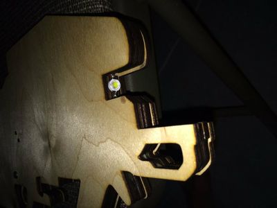

This is a simple circuit just consisting of a battery, LED, resistor and switch.
Switch: I chose a spring loaded limit with with lever arm that I had already in my parts bin. This is great because it kicks the trigger back when released without the need for extra springs/components.
Resistor: The resistor is there to limit the current passing through the LED. I bought the LEDs on Amazon so I didn't have a data sheet. I went off of customer reviews for how much amperage I could pass without requiring a heat sink. I then hooked it up to a bench top power supply and tests different voltage/current combinations and found that 2.88 volts passed approximately 140 mA through this LED. A quick calculation later and I determined that a 7 ohm resistor would cover my bases when the LiPo was fully charged 4.2v and when nearly fully discharged 3.7v. A 1/4W resistor was sufficient. I had a bag of 8.2 ohm laying around and the increased resistance did not result in a meaningful drop in light output.
Battery: I previously purchased this 2500 mAh battery from Adafruit for another project and didn't end up using it. This is a big battery for this simple project and will ensure my son can use this thing non-stop on Halloween without any worry of running out of juice when trying to kill that evil Covenant race.
LED: As I mentioned above, I purchased these from Amazon for about 20 cents each. They do not disappoint given their small package and minimal current draw.
Wire everything up as shown in the pictures. Positive of the battery to the NO terminal on the switch, Resistor to the COM terminal, through a wire to the positive side of the LED. Negative of the LED connected via wire to the negative of the battery. First grade circuitry.
Click the switch, does it light? Good job.
