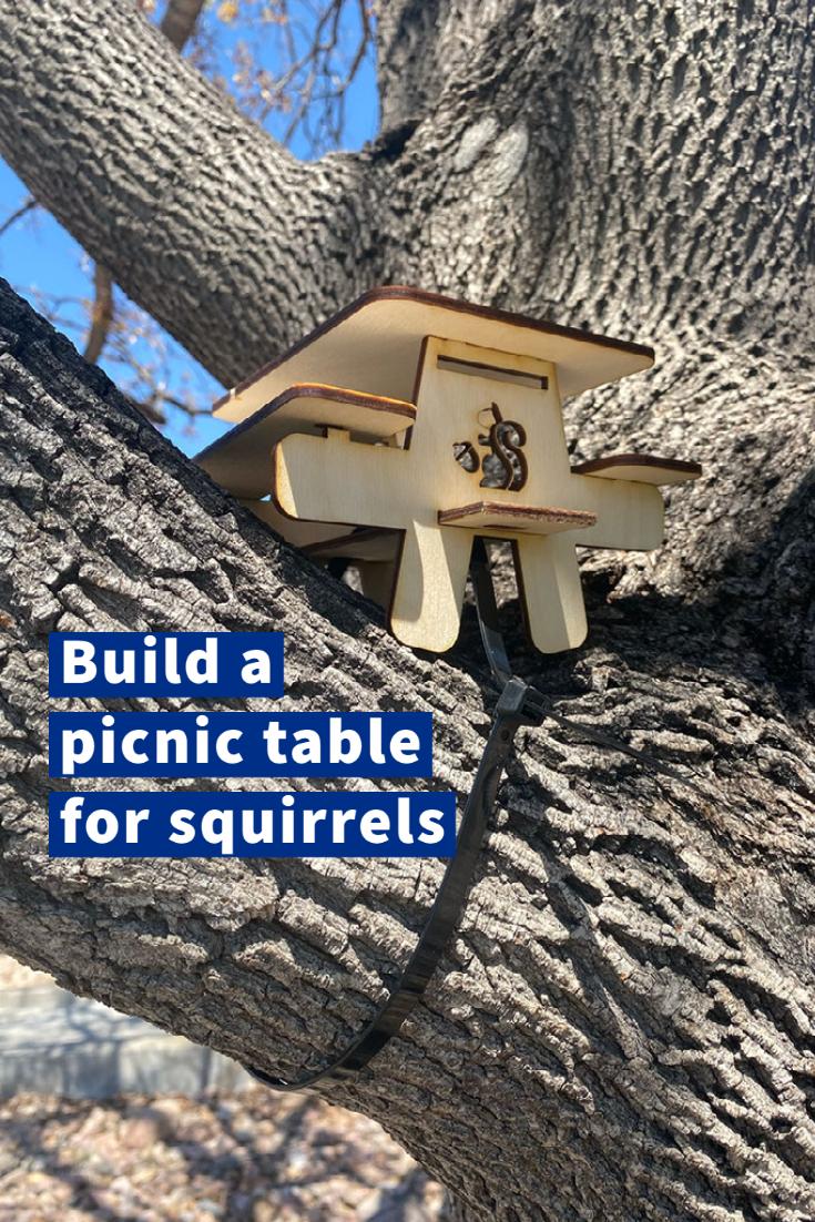

This guide will help you assemble the inventHQ squirrel picnic table!

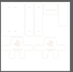

Step 1: Download File and Laser Cut the Pieces.
Skip this step if you already have the pieces.
This file uses a 12x12in 1/8" piece of birch plywood.

Materials include:
  • 1 tabletop
  • 2 bench tops
  • 2 leg pieces
  • 2 zip ties
  • Face or back mounting piece
  • Mounting bar

Step 7: Decorate!
Great job! Your table is assembled! Now is the time to decorate! You could add paint, stain, or other creative elements!

Step 9: Option 1: Mounting on a Fence or Pole
Option 1: Using the mounting bracket. Secure the face piece with a zip tie around a fence, pole, or smaller tree branch. Slide your picnic table onto the mounting bar through either the upper or lower rectangle cutouts on the leg pieces.
Step 10: Option 2: Mounting on a Tree Branch
Option 2: Balancing the picnic table on a branch.
The table can also be mounted with just the mounting bar (long rectangle) and zip ties pulled through the holes on the mounting bar.
Step 11: Now Wait for Some Furry Friends to Arrive!
