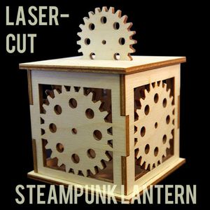

I have always liked the Steampunk aesthetic, dating back decades before it was labelled as such. Thus, many of my projects will reflect the same theme.
For this, my second Instructable, I give you a 2 3/4" Steampunk Lantern. Please use this project for personal, non-commercial use only.

You should have a total of eight pieces: four sides, the lid, inner lid panel, handle and the bottom (with my seal and copyright).

Step 8: Ta-Da!
Now that you've completed the assembly of your Steampunk Lantern, you can decide if you want to paint it, stain it or just varnish the wood! If there is enough interest, I will add tutorials on different finishing techniques, from metallic faux finishes to stained and varnished wood finishes.
This project was designed specifically for use as a Lantern/Tea Light (battery-operated ONLY; no open flames), but it could be filled with potpourri if you like that kind of thing. Once you've made it, what you do with it is up to you! As always, just be safe and have fun with it!
