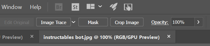

Once you bring in an image, click on it to select it. This should open up some new options in the top tool bar. Namely, image trace. Click image trace, and the image will change color somewhat. On the far left side fo the top tool bar is a drop down menu titled preset (this is still only visible if the image is selected). Click the menu to drop it down and select black and white logo. This will make the image black and white, so it will raster better. Copy the image, and paste it into the tissue box pieces file I have provided. Next, select and delete the default image I included in the file, and paste in your modified image in its place. Now, you are ready to cut out your customized file.
