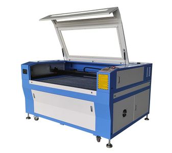

Step 4: Laser Cut the Shapes
Put each sheet of acrylic in the laser cut and send the .dxf to the machine to cut out. I used a speed of 5mm/s and a strength of 80-90%.
