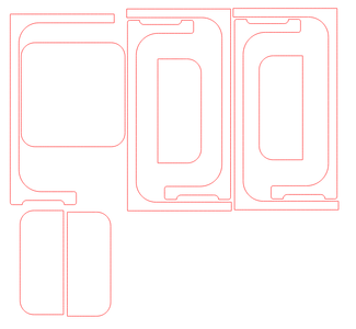

Step 1: Draw the Diagram
In order to make the headphone stand first of all we make a sketch or design in our mind for the stand and draw it on coral draw like this.

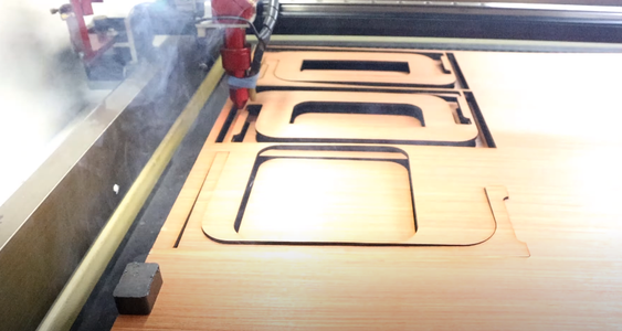

Step 2: Cut the Plywood With CNC Laser Cutting Machine

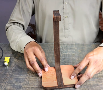

After drawing the diagram we cut it with a 100w machine with a speed of 25mm/s and power of 45%. The stand consists of two parts base (with 3 layers ) and the stand (with 3 layers).

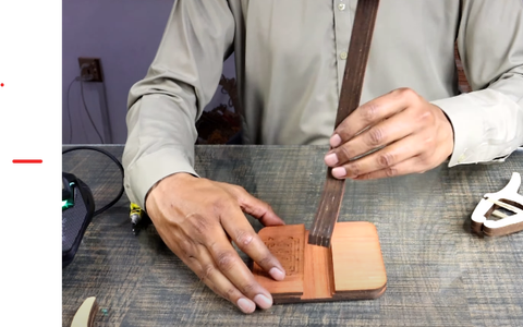

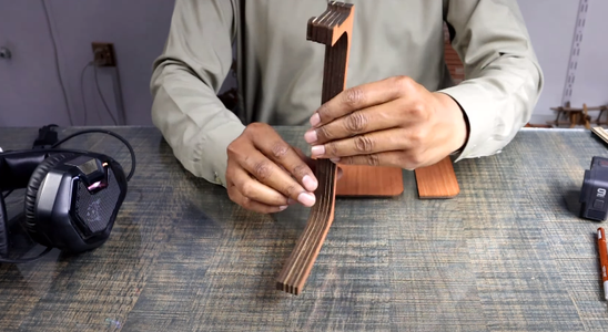

Step 3: Assemble
we joined the stand(4mm) from one to another and press it with clippers to fix them well.

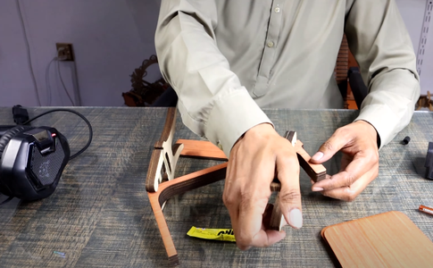

Step 4: 1st Base
Now we arranged the first base and put the stand between them.
Step 5: Final Assembly
Like this and then we take another base and fix it with glue and press it for that they joined well.
The stand is ready and here it's final look and it looks a lot nicer.
