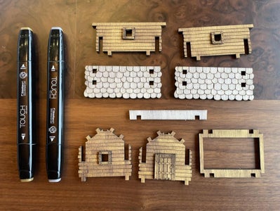

Step 1: Cut and Engrave the Parts on a Laser Cutter
Start by cutting out the parts - engraving the black lines and cutting the red on 4mm plywood.
The SVG file is attached here.
Step 2: Colour the Parts
Colour the parts - you can stain or paint but I used dual tip markers in light grey and brown. Do both sides!
Step 3: Sand and Glue Together...
The two roof panels will need lightly sanding on the top edge at 45 degrees to connect neatly to the top beam. See picture.
Having done this, glue the parts together using wood glue...
