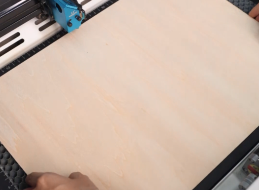

Step 1: Place the Wood on the Laser Bed
Start by laying your wooden board flat on the laser bed. Make sure the surface is clean and sits evenly without warping. If needed, use magnets or light tape at the edges to keep the board from shifting during cutting.
put the wood on the laser bed

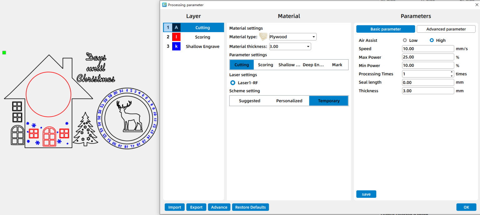

Step 2: Open the File and Check the Settings
Open your laser software(I use LaserMaker) and import the Christmas calendar design file. Adjust the layout so it fits properly within your material size. Before moving on, double-check your engraving and cutting parameters to match the thickness and type of wood you’re using.
parameters for laser cutting the christmas calendar

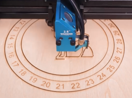

Step 5: Monitor the Laser Cutting Process
Stay close to the machine while it’s running and watch the cutting and engraving progress. Keep an eye out for excessive smoke, small flame-ups, or any movement of the material that could affect the outcome. Make sure your workspace is well-ventilated, and rely on air assist if available to achieve cleaner edges on the wood.
laser cutting the christmas countdown calendar

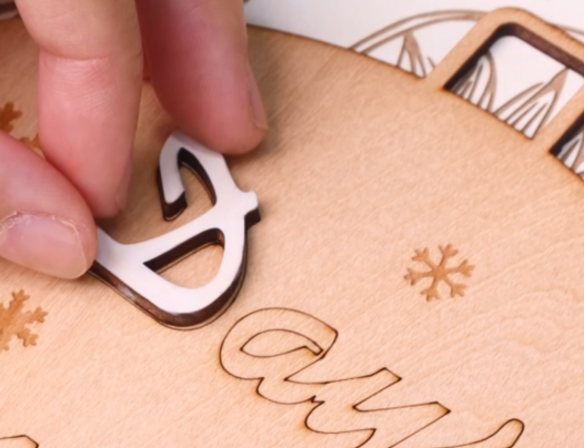

Step 7: Assemble the Calendar
Align the joints and slots as designed and assemble the calendar piece by piece.
stick parts to the calendar
