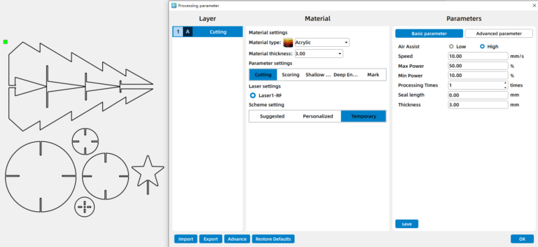

Laser Cutting
  1. Speed:10mm/s
  2. Max Power:50%
  3. Min Power:10%
  4. Frequency:20kHz
  5. Passes:1

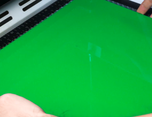

Step 1: Place the Acrylic Sheet on the Work Table
Start by peeling off the protective film from the top surface of the acrylic sheet—the side that faces the laser. This prevents burn marks or smoke stains from forming on the visible surface during cutting. You can leave the bottom film on to protect the underside while it rests on the workbed. Once ready, place the acrylic flat on the laser cutter’s bed and secure it with pins or magnets.
put the green acrylic on the work table
Step 2: Import the File and Check the Settings
Open your preferred laser software (I use LaserMaker) and import the design file. Adjust the size and layout as needed, making sure the designs are evenly spaced to make the most of your acrylic sheet. For the laser cutting layers, pay extra attention to the minimum power setting. If the min power is too low, it will cause the cutting corners will not cut through; if the min power is too high, the laser cutting will be bad at the corners.
Parameters for laser cutting a Christmas Tree Storage Rack

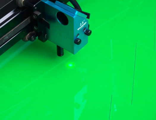

Step 3: Focus Your Laser Machine
Accurate focusing is critical for achieving smooth, clean cuts on acrylic. The Thunder Bolt offers two focusing methods:
·Auto Focus: With one click, the laser head automatically adjusts to the optimal focal distance. This is fast and convenient for flat materials like acrylic sheets.
·Manual Focus: For more control or when working with uneven materials, use the focus stick. Lower or raise the laser head until the focus stick stands perfectly vertical against the acrylic surface—this indicates the correct distance.
Tip: If your material is slightly warped or not perfectly flat, manual focus is recommended for more precise results.

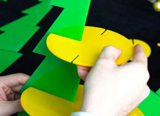

Step 6: Assemble the Pieces
Once cutting is complete, remove the parts from the laser bed. Align the slots and tabs according to the design and assemble the rack step by step.
assemble the christmas tree storage rack

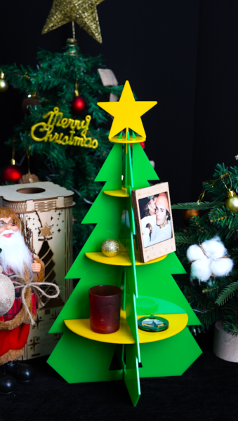

Step 7: Complete the Task
Check the assembled rack for stability and alignment. Once everything fits securely, the Christmas tree storage rack is ready to use.
