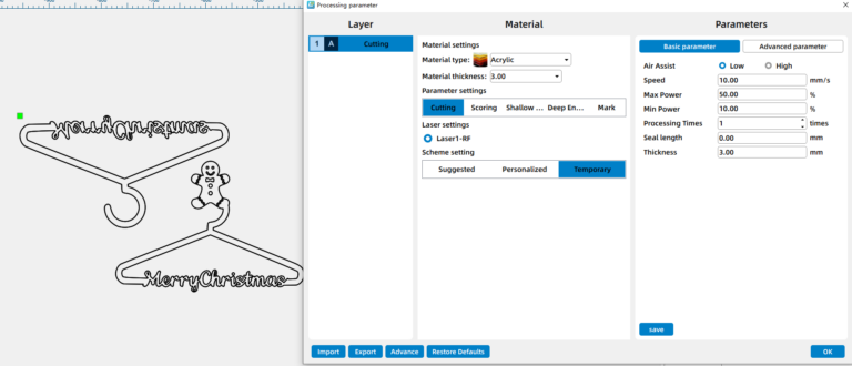

Laser Cutting
  1. Speed:10mm/s
  2. Max Power:50%
  3. Min Power:10%
  4. Frequency:20kHz
  5. Passes:1

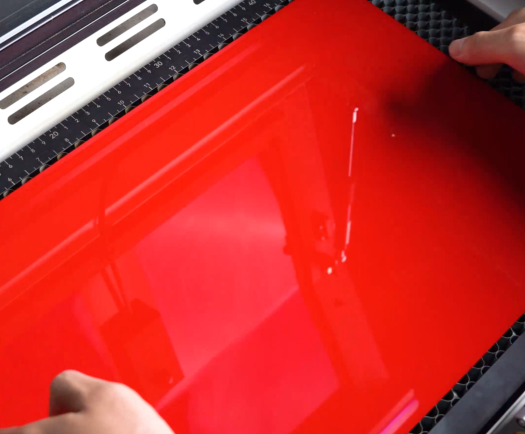

Step 1: Place the Acrylic Sheet on the Work Table
Start by peeling off the protective film from the top surface of the acrylic sheet—the side that faces the laser. This prevents burn marks or smoke stains from forming on the visible surface during cutting. You can leave the bottom film on to protect the underside while it rests on the workbed. Once ready, place the acrylic flat on the laser cutter’s bed and secure it with pins or magnets.
put the arcylic on the laser bed
Step 2: Import the File and Check the Settings
Open your preferred laser software (I use LaserMaker) and import the design file. Adjust the size and layout as needed, making sure the designs are evenly spaced to make the most of your acrylic sheet.
For the laser cutting layers, pay extra attention to the minimum power setting. If the min power is too low, it will cause the cutting corners will not cut through; if the min power is too high, the laser cutting will be bad at the corners.
parameters for laser cutting an acylic christmas hanger

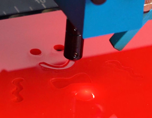

Step 4: Frame the Design and Start Laser Cutting
Before starting the job, run the frame function(also called border) in your software. The laser head will trace the outline of the design with a visible guide light. This helps confirm that the design fits within your acrylic sheet and avoids wasting material. Once everything is adjusted, simply press ‘Start’ to begin laser cutting the acrylic with the Thunder Bolt.
Frame your design
Step 5: Monitor the Laser Cutting Process
Monitor the job as it runs—watch for excessive smoke, movement of the acrylic sheet, or any warning alarms. Never leave the laser unattended while it’s operating.
While observing, remember that the laser beam is extremely powerful. Even with the protective lid closed, avoid staring directly at the marking spot for too long. A quick glance to check progress is fine, but prolonged gazing should be avoided for safety reasons.
laser cutting the acylic

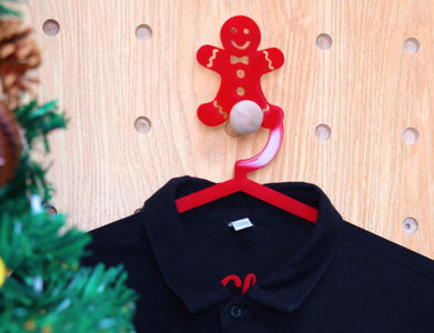

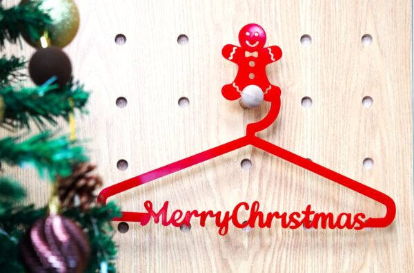

Step 6: Complete the Task
Once the cutting is complete, remove the hanger from the bed. If the back side’s protective film is still on, peel it off to reveal the glossy, festive finish.
Now your adorable Christmas acrylic hanger is ready to use or gift!
