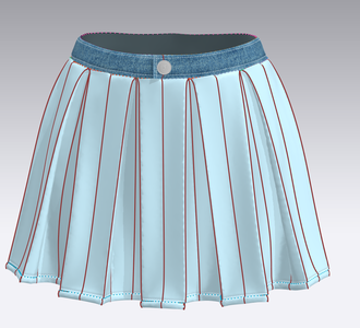

I first drafted a skirt design in CLO3D that included ruffles, but realized I didn’t have enough material and that the engraving would not show well on that style. I simplified the skirt into a clean, straight shape. For the top, I sketched it out by hand and then created a pattern in Fusion.

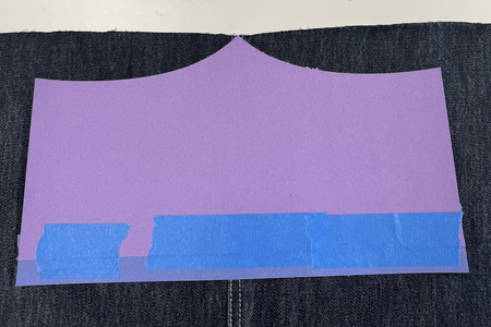

Step 2: Cutting the Top Pattern
I laser-cut the top pattern onto paper and used those cutouts to cut fabric from an old pair of denim pants. I folded the top pieces and added small stitched darts to give the bust area more dimension.

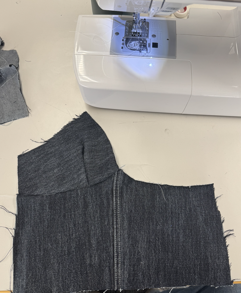

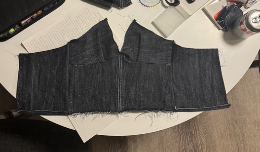

Step 3: Sewing the Top
I sewed all the top pieces together and hemmed the edges to prevent fraying. For the bottom edge, however, I left it raw because I liked the distressed, frayed look.

Step 5: Adding Grommets and Straps
Using a grommet tool, I added eyelets to the back of the top and sewed the straps securely attached them. I also attached neck straps that could be tied at the back of the neck.

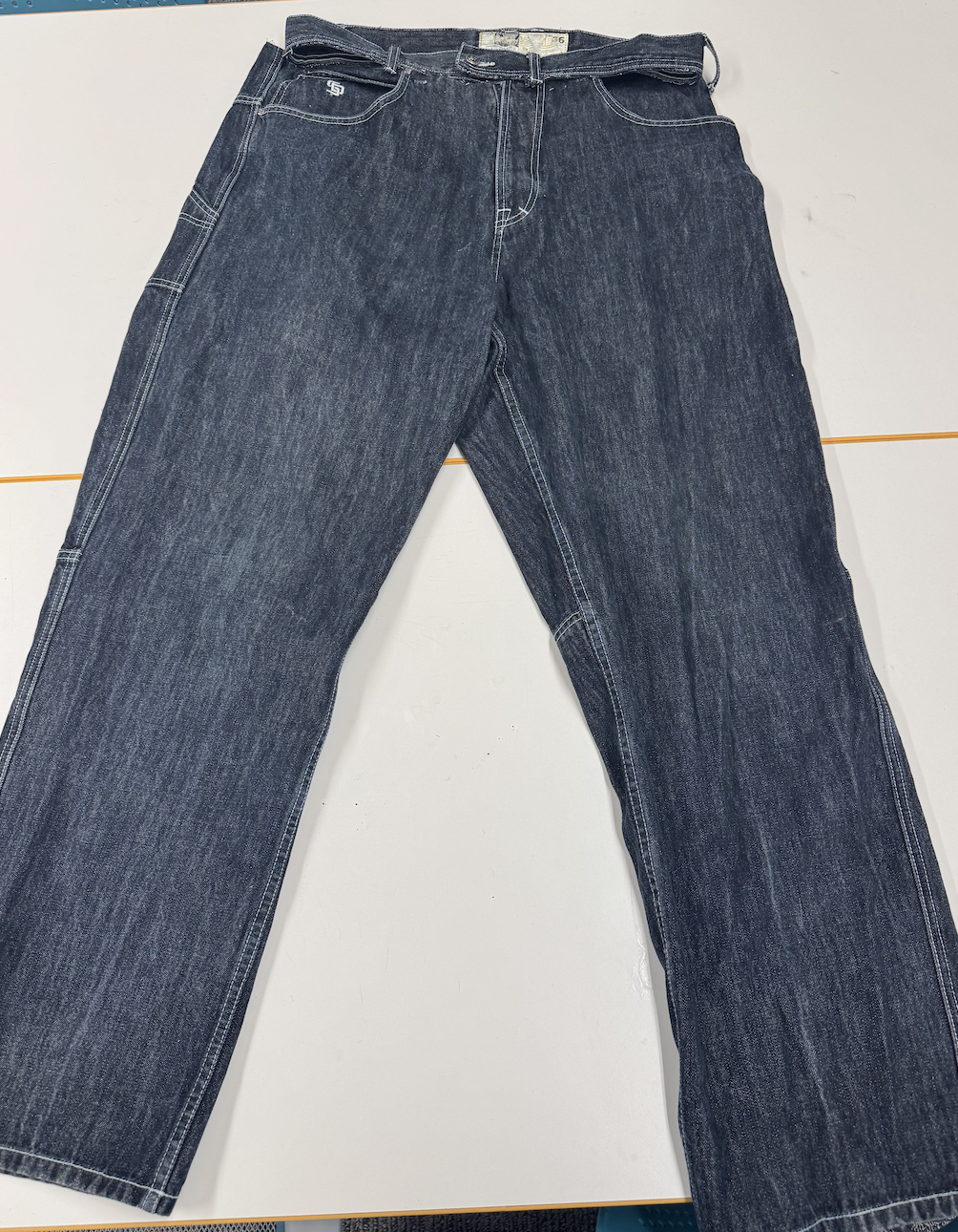

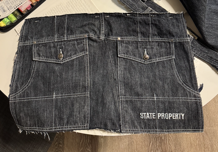

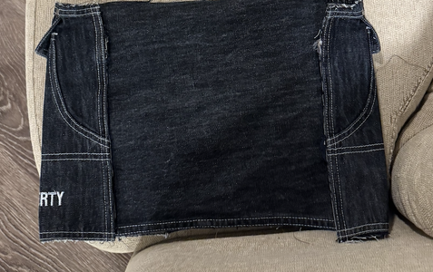

For the skirt, I cut the back panel from the back of the jeans, keeping the original pockets intact as well as adjusting it to look more like a skirt. Then, I cut the front panel from one of the pant legs and attached both pieces together to form a rectangular skirt base.

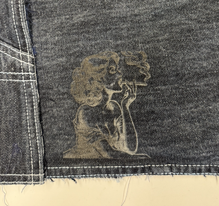

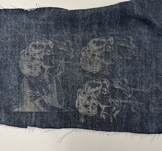

I cropped and adjusted the image I wanted to engrave in Adobe Illustrator. Before engraving, I tested settings on scrap denim material, experimenting with power levels to get the depth and color I wanted.

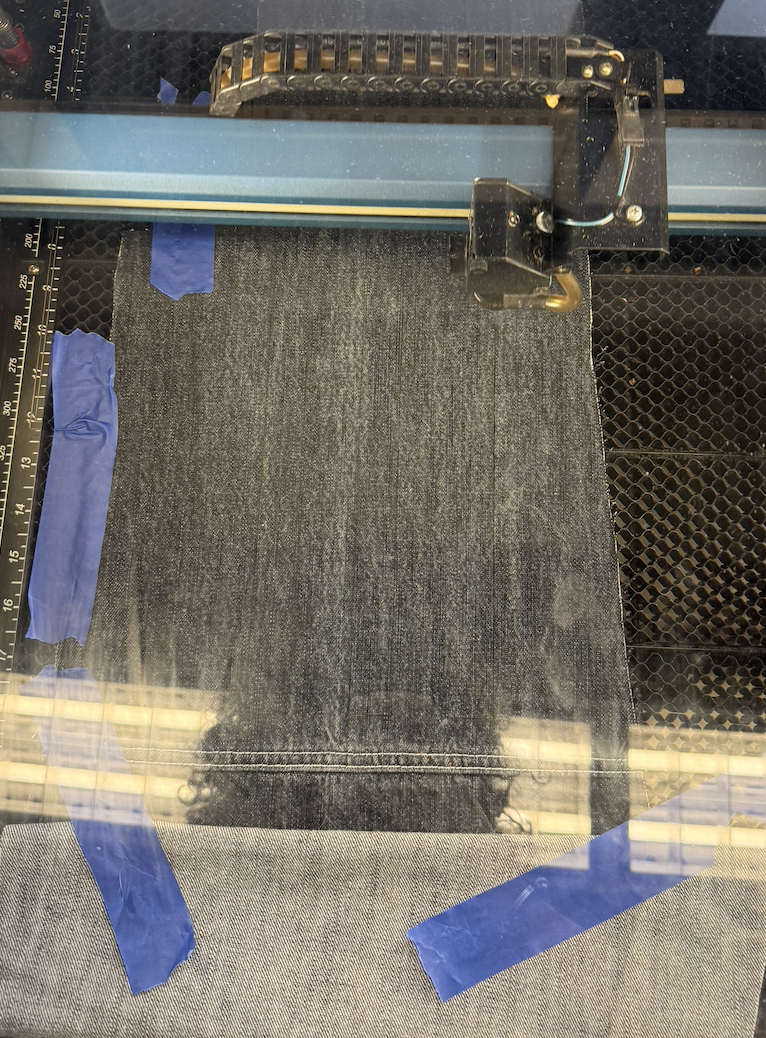

Step 8: Laser Engraving the Skirt
Once I found the right settings, I laser engraved the final design onto the front of the skirt.
