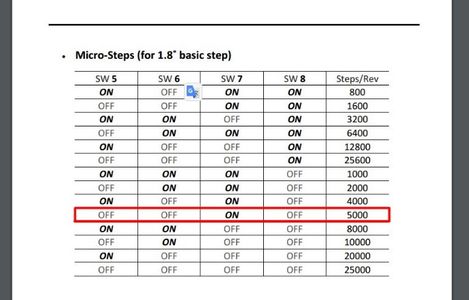

Step 1: Steps Per Revolution
First think you need to find out the steps per revolution of your motor driver. Thats the amount of pulses the controller needs to send to motor driver for motor to complete one rotation.
Open your (turned off) laser cutter and check the driver name and rotation settings.
The photo is not the best as the driver name is behind the cables but it is: 2M542, and the rotation setting of the DIP switch were like on the image table attached.
Rotation setting are the 8,7,6,5 position of the switch, in green on image.
You can find manual for your driver which will be somewhere on internet, this is for 2M542 : http://www.hi-end.ro/pdf/motoare/CMP5042.pdf, but i would say the drivers have some standards and it is probably the same. (but rather check)
In the documentation i found a match for the switch configuration of my driver and it was set to 5000 pulses/rev. (see image)

Step 3: Circle Pulse
So 5000 steps must be sent to motor driver for the motor to rotate 1 full revolution
5000 steps *1.6ratio = 8000 Circle Pulse
8000 steps to turn your roller one full revolution.
