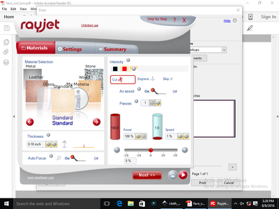

We need to adjust a few things on the design so that the laser behaves the way we want. Specifically, we need to make sure that the line color and stroke size are set in such a way that the laser's control software knows to cut along these lines--as opposed to engraving.
As pictured above, set your stroke color to Red and your stroke size to 0.03mm --the RayJet will only cut along "hairlines" such as 0.03mm
**Note, if you were both cutting and engraving within the same design, you would set any engraving line's stroke color to Black

Open you PDF file in Acrobat Reader. Click on "Print" and select the "Properties" button.
Step 6: Laser Properties
When you click on "Properties" a menu with many options appears. Make sure that the following are set:
-Material Thickness
Under the "Red" tab (you may add more tabs):
-Power 100%
-Speed 1% ...for engraving this can be faster, but cutting needs to be very slow.
If you were using multiple colors for different types of cut/engraving, you would adjust each accordingly. For example, if you needed to engrave Black lines you would switch the settings under it's tab to "engrave" "power: 90%", and "speed: 10%"
Step 7: Finalize Settings
In the next menu screen, the default settings tend to work well. Just make sure check the box for "Cutting Table" if you have one in.
Finally, look over the settings in the last menu screen and hit "Process" in the bottom right-hand corner to apply the setting to the job.
Lastly, hit "Print" back in Acrobat Reader and you're good to go!
