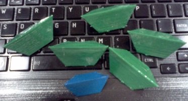

Step 2: 2nd Laser Cut ... for Pyramid Puzzle Pieces ...
Okay, we have the two ends cut out nicely, now you stand up the block of material on the flat side (end of the pyramid piece) so we can make the next laser cuts to finish the cutting. Yes, that's all it takes ... really just two cuts and you have a neat little 3D Puzzle Piece.
So using your sketching software (Again, I used SolidWorks myself) you then make the cuts just as they appear in the image PyramidPuzzle-04 ... it's so easy, like chopping off two ears of a head ... but in this case it's just the squaring material of the pyramid block.
When the laser cutting is done and you've removed the excess materials from the puzzle piece it should look like image PyramidPuzzle-06.

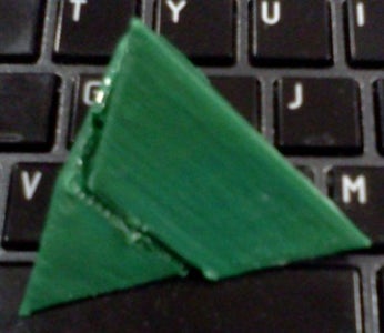

Step 3: Assembling the Two Puzzle Pieces ...
Okay, this is the puzzle ... to assemble the two pieces into a 3-sided pyramid. It's easy, but is a brain teaser. I suggest you try it yourself before learning the secret to how the human brain works.
DO NOT SCROLL DOWN UNTIL YOU HAVE TRIED THE PUZZLE YOURSELF!
Okay, now here's the brain teaser ... the human brain likes to fill in the blanks, make things parallel and symmetrical but to build the pyramid from two exact halves requires you to turn the two pieces 90° opposite each other ... simply fit the two 30mm x 30mm square surfaces face to face ... then turn the two pieces 90° opposite each other and you got your pyramid. You can see this in image PyramidPuzzle-08 ... It's so easy! ha ha ha ...
