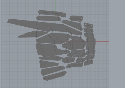

Step 3: Create the Model of Armor
According to the size of the first hand left the model to establish it, In fact here the model can not be be very accurate. but probably enough to use~ Here I made the armor model piece by piece, try to make every piece of armor close to arm.
Step 4: Expand the Armor and Design the Shape of Washed Kraft Paper
Expand armor is a tiring job, a piece of paved, no shortcuts. After paving, to draw the outline of washed kraft paper, arm armor is to use the stapler fixed on the washed kraft paper. In order to make armor and kraft paper position easier alignment, we need to add some notes.
Finally add part of the hand, leaving the hole of the LED pin.
