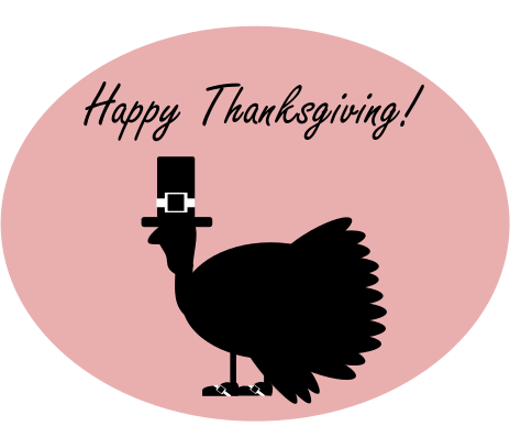

Your tabs can be as detailed as you please. We designed our tabs using the text feature to write text and then adjusted the font and size to fit the tab. For images, we would either search for stock images, filtered for transparent backgrounds, or click the Window tab, then scroll to image trace, and then finally change the preset to silhouettes. Both are effective strategies for removing unwanted backgrounds from your desired images. You can import these images by going to File and then Place. Scale and adjust them according to how you best see fit.
