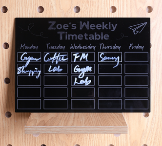

Step 1: Place Your Materials for Laser Engraving
Peel off the protective film from the top surface of the acrylic sheet. Leave the back film on to reduce scratches while cutting. Place the sheet flat on the work bed and secure it with pins or magnets so it doesn’t shift during engraving.
put the acrylic on the work table
Step 2: Open the File With Your Laser Sofeware
Load your weekly planner design into your laser software ((I used Lasermaker). Adjust the size and positioning so it matches the area of your acrylic sheet. Before you begin, double-check your engraving and cutting parameters. For acrylic, ensure the speed, power, and line interval are appropriate for the thickness of your sheet. Engraving settings should be optimized for clear, sharp text and lines, while cutting settings should provide a clean edge without excessive melting. Running a small test on scrap acrylic is always a good idea.
parameters for engraving a weekly planner on black acrylic
Step 3: Focus Your Laser Machine
Proper focusing is essential for achieving crisp engravings and smooth cuts. If your machine supports auto focus, a single click will set the correct distance for flat acrylic sheet. If you prefer manual focus, use the focus stick to adjust the laser head until it just touches the surface of the acrylic at a perfect vertical angle. Spending an extra moment on accurate focusing will pay off with professional-looking results.
auto focus
Step 4: Frame the Design and Start Laser Engraving
Run the framing outline to double-check that the design fits perfectly on the acrylic sheet. The red-light outline gave me confidence that everything was aligned. Once satisfied, I clicked Start, and the laser began cutting the planet puzzle pieces with smooth precision.
laser world map 3
Step 5: Monitor the Laser Engraving Process
Stay near the machine while it’s running and watch the cutting and engraving progress. Keep an eye out for excessive smoke, small flame-ups, or any movement of the material that could affect the outcome. Make sure your workspace is well-ventilated, and rely on air assist if available to achieve cleaner edges on the acrylic.
Laser engraving the weekly planner on the acrylic
Step 6: Clean the Acrylic and Complete the Job
Once the job is complete, wait a few seconds for fumes to clear before opening the lid. Carefully remove the acrylic piece. Peel off any remaining protective film and wipe the surface with a soft cloth. For a spotless finish, rinse lightly with mild soap and water. If your planner comes with a stand, assemble it by aligning the laser-cut parts. Once set up, you can write on the surface with dry-erase markers and wipe it clean for reuse week after week.
My weekly planner is already on my desk, keeping me on track—what about yours? Making one is simpler than you might think, and the result is a planner that feels personal, reusable, and a little special every time you write on it.
Why not give it a try? I bet you’ll come up with a version even better than mine—and I’d love to see what you design!
Write down your plan on the planner
