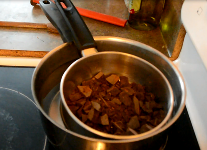

I decided to make my own chocolate sheets. Making chocolate sheets can be a very tricky process so if you don't want to struggle you can by some from the dollar store and skip this step.
I used 100 grams ( approx. 8 oz) of dark chocolate that i cut into small pieces to make it melt evenly. I am using a technique called Bain Marie which consist in putting a small pan into a hot -but not boiling- water pan.
It is really important to stir and monitor closely your melting chocolate thoughout the process.
Once your mixture reaches 55°C, remove the chocolate from the heat and let it cool until it reaches 23°C. You can put you pan in snow to help the process.
Once you reach 23°C, put it back in the hot water until the chocolate reaches 35°C. This step happens realy quick so take care.
