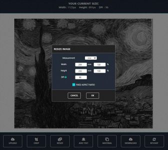

Creative Space has built-in tools for preparing images for engraving, but I prefer using ImagR for this type of project due to its additional functionality. ImagR is a free, web-based software that’s straightforward to use.
  1. Select your image and upload it into ImagR in greyscale.
  2. Crop and resize the image to fit your canvas.

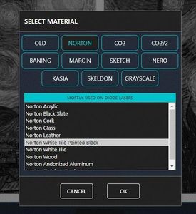

  3. Select the engraving material. For a diode laser, choose "Norton White Tile Painted Black" to get a negative image.

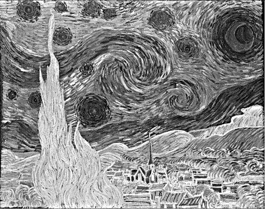

  4. Adjust the Gamma, Brightness, and Contrast. This step requires some guesswork. I typically set the Gamma Adjustment around 1.3, but Brightness and Contrast depend on the original image and the effect you're aiming for. I used a Brightness of 15 and Contrast of 0, but a higher Brightness might have been better.
  5. Download the new image.
