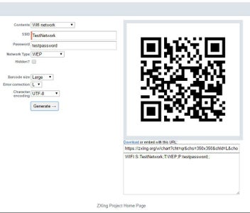

There are a number of websites, and apps probably, that will work to generate your QR Code. I used THIS one and it worked fine but feel free to use your favorite, as long as generating WiFi credentials is among its functionality.
Once you choose a method then simply enter your SSID, password, and encryption type. Be sure to scan the generated code with a bar code scanner, I use THIS one, to verify that it works and if it does, save the code as an image and move on.

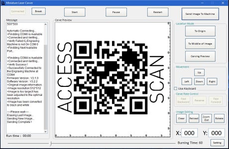

The NEJE engraver I used has its own software that accepts a single image as its input. This means I had to do a little manipulation before setting it on its marry way. For this I use Paint.NET, which is a good, free, and expandable, Photoshop alternative for mid level work.
The real limiting factor for the engraver is the small size, using images with resolutions of 512x512. To keep everything a readable size I had to break the face into two images and cut them in two separate sessions.
Using Paint.NET I shrunk the images and added text, making sure my orientation was correct for the engraver.

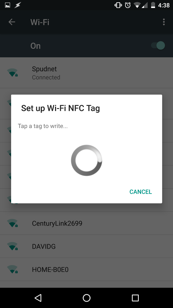

While the laser runs, get your NFC tag ready to go. If you have Android Marshmallow then you can use the built in WiFi manager to write the info to a tag. If you don't then you will need a third party app, like NFC Tools, to write it. You can see both methods in the video above or steps below.
Marshmallow
  1. Open Settings... WiFi.
  2. Long press on the network you want to save.
  3. Select "Write to NFC Tag".
  4. Enter the network password and confirm. Place your phone over a NFC Tag to write.
