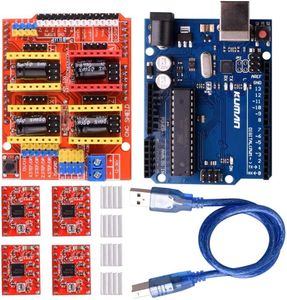

CNC Shield Expansion for Arduino Uno: This kit contains most of the electronics needed for this project. Assembly will be detailed in a later step.

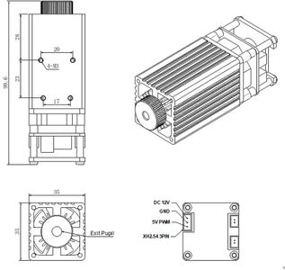

20W Laser Module 5V PWM: This is the laser we will be using for the project.

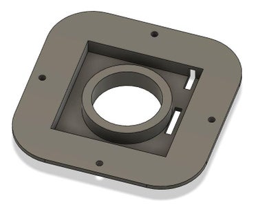

Next is the top plate, or plates more accurately. Designing this one can be challenging, but once the hole measurements have been confirmed everything else is a breeze. For the initial plate design, I recommend imagining which side the laser tower is going to be on and making the respective side of the top plate stick out the least on that side. Other than this limitation, the build plate can be any shape you desire, just make sure there is wood underneath where the cutting area will be. Once you have the top plate designed, you will probably need spacers to go in between your plate and the frame in order to avoid hitting the center mass of the top SMM. Its best you design these yourself as the height and the diameter of the screws may be different for you as they were for me. They don't need to be complicated, and there doesn't need to be more than one type like mine either, but make sure the screws you're using can go through them and have enough length for a nut left over. After getting the initial top plate cut out and installed, a second plate can be made to fit over the screw heads. Something to keep in mind is that to prevent the second top plate from moving around, the holes should fit snugly around the screw heads. This new plate has the benefit of being easily removable which means taping down engraving material is easier, and replacement incase of an accident is easier as well.
This is a reminder that your cut area will be small. The range of motion on my SMMs was around 33 millimeters which means I ended up with a 33 by 33 mm cut area. It is labeled directly onto the second plate in one of the images above.

Now that the CNC platform has been largely completed, it is time to turn towards the electronics. In the images above there are four components. An Arduino Uno (left), the CNC shield (right), and two stepper motor drivers (top). The shield goes on top of the Uno, but the drivers have four spots to potentially be placed. Each of those four spots are labeled "X", "Y", "Z", and "A". The stepper drivers should go into the "X" and "Y" spots. As for their orientation in those spots, there is a pin labeled on the under side of the stepper driver as "En". There should be a hole on the CNC shield that matches this.
After those components are assembled the hard plastic ends of a group of four jumper cables should be cut off and the wires stripped. The stripped wires should be soldered to the points on the stepper motor and the non cut end of the group should be plugged into the shield next to the drivers as shown above. The order of the wires pugged into the shield relative to where the wires were soldered on the stepper motor did not seem to matter, but I advise against changing them later once the software is involved. I recommend attaching the wires to the frame in order to prevent the soldering points from being too stressed. I used Sugru, but any from of solid attachment will work. Finally, the female jack can be installed by inserting the two wires into their respective receptacles in the blue piece on the CNC Shield. Make sure the red wire is in the positive area and the black wire is in the negative.

This step will contain the electrical connections of the laser, the construction of the base plate, and the installation of the laser. First off, the laser module should have three pins (three wires) coming out of the top of it. The diagram above shows the three pins and what they are in the bottom right. Just incase your wires' colors do not match my own, the red wire is the 12V pin, the black wire is ground, and the yellow wire is the PWM within my pictures. The red wire and the black wire go to the same spots as the female jack while the yellow wire plugs into the white Z+ pin. In reality, the yellow wire should connect to the spindle enable pin because its purpose is to control the power of the laser (our "spindle" in this case), but due to software changes, the shield's labeling is now incorrect. The wiring on your shield should look like the pictures above. This is the final wiring setup. It is now time for the base plate.

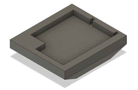

The base plate is the last file you will have to make yourself because of the SMMs. The actual dxf file of the sketch above is linked below, so if you would like to simply alter the distances between each leg, you can do so. I don't recommend cutting out the spot for the Arduino. The base plate, similar to the top plate, has two layers of wood. The top layer has the pattern of the legs and the tower base cut all the way through, and the bottom layer only has the outer rim cut out. When these two layers are glued together, an indent is formed for the tower and the legs to go into.

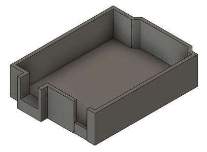

Two unnecessary, but cool looking, pieces I added to the finished Laser Engraver were the electronics case and the wire spool. The electronics case encases the Arduino/CNC Shield unit in plastic and the wire spool offers a way to shorten the laser wire by wrapping it around a center column. These two are largely pointless, but they helped fill the remaining space on the base plate and look nice doing it. The files for them are linked down below.
