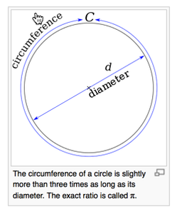

When creating your graphics, you want the finished file to be as wide as the circumference of your rolling pin and as tall as your rolling pin barrel.
As a quick geometry refresher – the diameter is how wide the barrel of the rolling pin is if you measured from the 2 widest outside points across the barrel. The circumference is the length if you wrapped a tape measure around the outside of the barrel. You can easily find the circumference if you take the diameter measurement and multiply it by 3.14.
