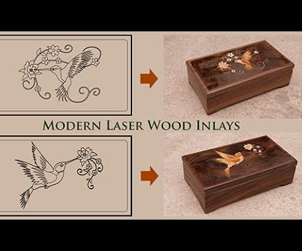

Introduction: Laser Marquetry & Inlays - Advanced Technique
Creating wood inlays for a wooden box
To create the inlay design on this wooden box (8x4 inches), I use Adobe Illustrator to draw the vector design and then use ImagePaint software, which is a plug-in for Adobe Illustrator, to apply the wood images I have scanned into the computer. With this method, I was able to see the whole design completely applied with wood images and position the vector shapes over desired locations on the wood image before instructing ImagePaint software to create the toolpaths and send them to my Epilog laser for cutting the wood veneers.

Please note, the design you see in this instruction was damaged during sanding, so the image above was taken from another design.
