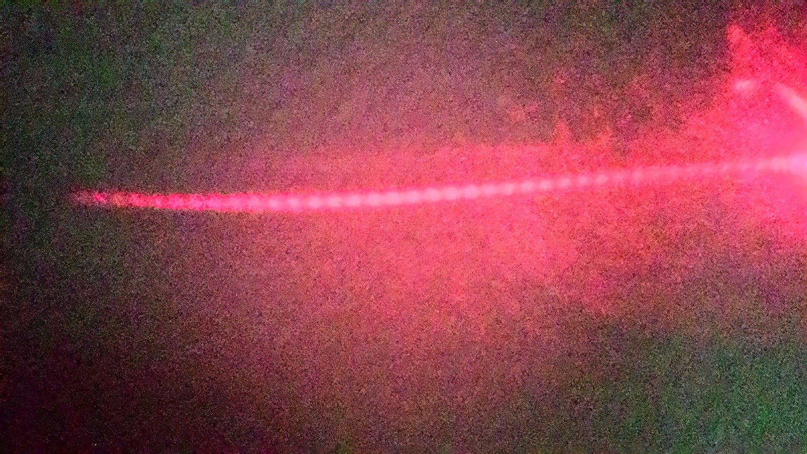

The thickness of copper wire which I got from an old electronic clock is around 5 to 10 micro meter. This will be good for our experiment. My key-chain laser has a wavelength of around 650nm or 0.65 micro meter. Diffraction can happen if the laser passes through this obstacle.
Wrap a thin copper wire around a tape and fasten it with some extra tape.
Place it on the stand or a box at a height as shown in images.
Place the laser set up as earlier (2 feet from wire setup)
Step 7: The LASER Show
Focus the laser beam in such a way that it should be cut by the thin wire. This leads to the diffraction pattern on the screen as described earlier.The fringes of the diffraction pattern are clearly visible as shown here.
