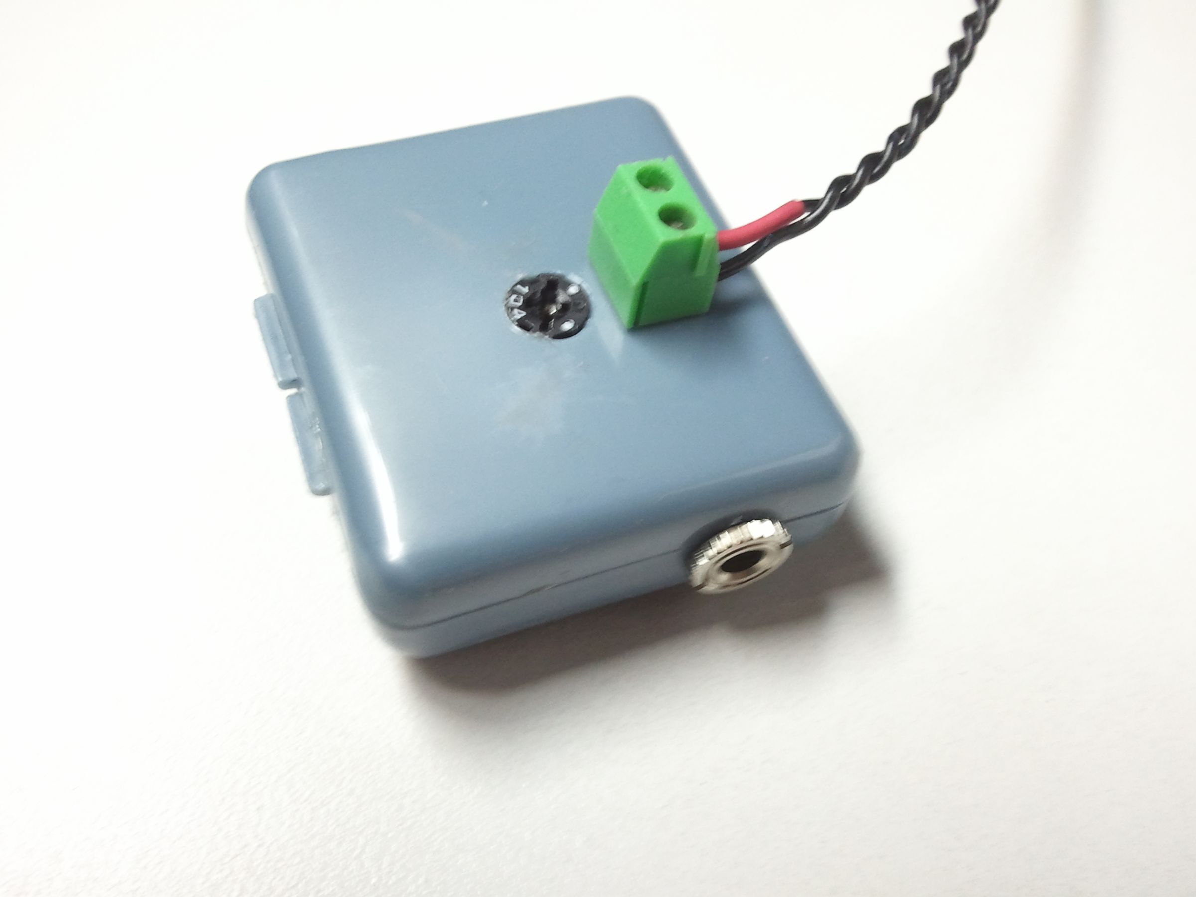

Step 5: Laser Sensor Schematic
Follow the schematic. After soldering everything in place, cut it out.
First picture= first sensor
Second picture= second sensor
Step 6: Done!
I made mine! Did you make your's?
If your having trouble laying out the circuit or trying to figure a way to put everything on a board to save the most space, you can take a look at mine as an example.
