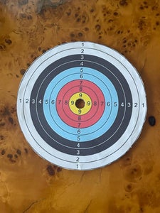

Step 1: Prepare the Target Board
Cut out the and stick it on the CD by glue
The diameter of the CD is 120 mm and the inner diameter is 15 mm.

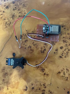

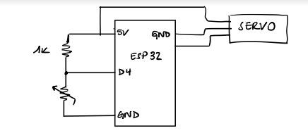

Step 2: Soldering the Target Components
We have welded the design we have attached above on a 5cmx7cm welding plate.
Please reserved some space between the servo and the welding plate. As the servo chassis may collide with the welding plate during servo arm moment.
Step 3: Tidy Up the Cable
Shorten the servo cable or tide the cable with string.
Please reserved some cable length for servo movement.

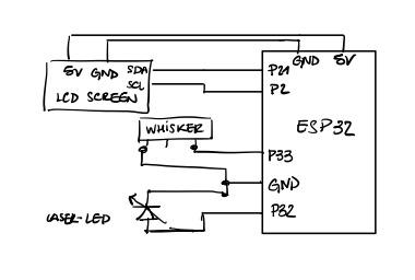

Step 4: Assembling the Laser Gun
1. We design our gun using the SolidWorks program.
2. We print the design using a 3D printer.
3. We add the LC screen in the corresponding hole.
4. We add inside the gun the ESP32 and with the circuit previously presented soldered on a soldering board.
