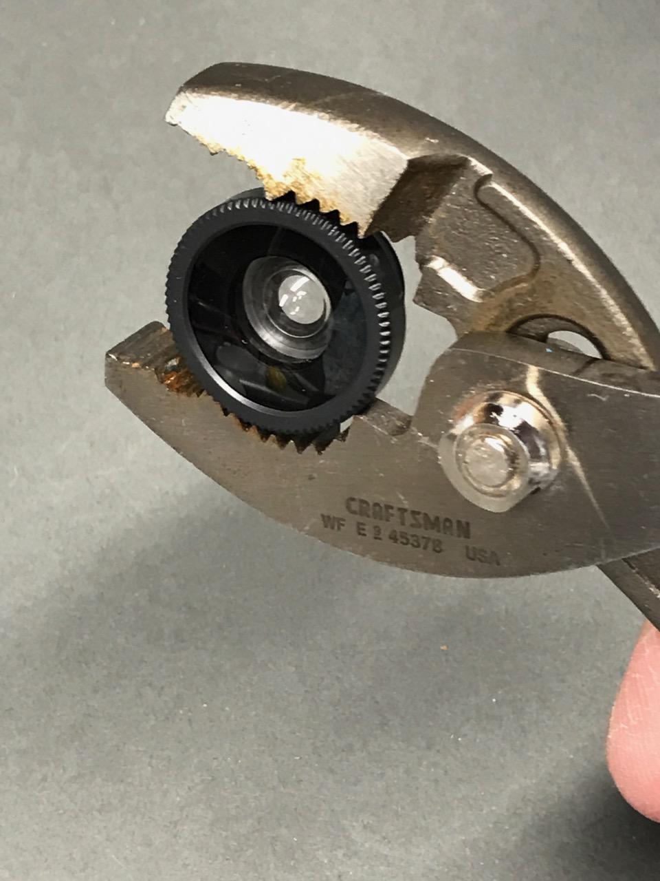

The laser beam needs to be spread into a cone of light. I found that inside the clip-on cell phone wide-angle lens was a double concave lens that worked nicely.
To get the lens apart I unscrewed it from its clip, removed the lens cap and gave the circumference several squeezes as I moved the pliers around. This cracked the glue and allowed the lens to come apart. The double concave is the one behind the front lens. You need two.

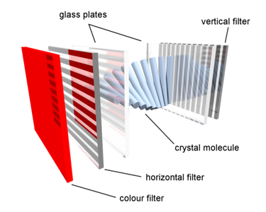

LCD panels are a bit of amazing technology. Polarized light is also pretty awesome itself.
LCD panels take advantage of the fact that vertically polarized light will not pass through a horizontally polarized filter. Think of it as light passing through venetian blinds; a vertical set follow by a horizontal set. Not much light gets through.
Liquid Crystals located between the two polarizers (the venetian blinds) twist the vertically polarized light to horizontal to allow it to pass through a horizontal polarizer. You can see in my last photo that taking a piece of polarizing filter will block all light when in a particular orientation.
As it turns out the light of many lasers is polarized. This can be taken advantage of as there is no need for one of the two polarizers. In addition if the liquid crystals alone are relied upon then no polarizing filters are needed at all.
