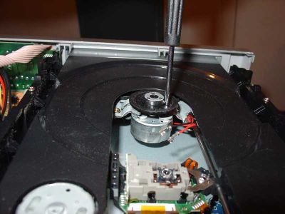

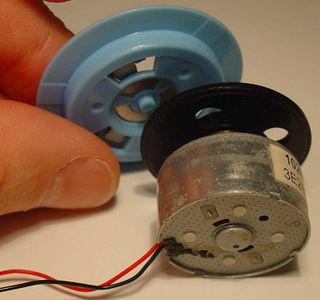

Extract your motor if you haven' already. These CD and DVD players usually come apart with a few screws. You can cut the wires but remember to leave enough connected to the motor so new leads can be connected.
The disk is often held to the motor with a magnetic clasp. These images show the mirror being glued to the clasp allowing the mirror to be removed from the motor for storage or swapping it for a mirror mounted on a different angle. You can glue the mirror directly to the motor without the magnetic clasp if you don't want the option to remove it.
With your hot glue gun, just glue the mirror to the motor using enough to prop the mirror up at a slight angle. A 15 degree angle or so is all you need and it dose not need to be perfect.
