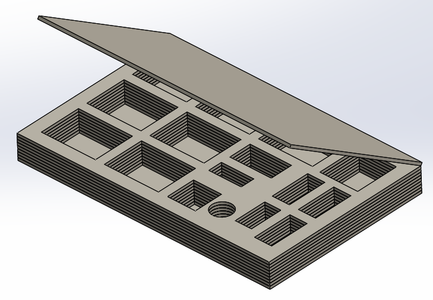

Step 2: CAD Drawing and Assembly
The CAD drawing that you will make can simply consist of a series of rectangles, but you can also create shapes that exactly match the contours of an item. For this example, I chose to use only different size rectangles and one circle.
I first decided on an overall size of 14" x 9". This area encompassed the part layout but otherwise is completely arbirary. The size of these modular trays will be driven by types of parts that you want the tray to hold and the manner in which you want to store them.
Use your CAD package to create this initial rectangle and then place additional shapes inside of it that match the size and shape of the individual components that you laid out in Step 1. Use a caliper or ruler to determine the size of each shape. I added an extra 1/8" to the height and width of each rectangle so that the parts are not too snug. If the parts you are storing are fragile, you can reduce this value so that the parts have less room to move about.
Once all the rectangles have been sized, I used sketch dimensions to fix their positions. In most cases, I have used a spacing of 1/2" between each part. Depending on your needs, this spacing could be reduced to 1/4".
Once the sketch has been created, you can go straight to the next step and laser cut the plate, however, I chose to create an assembly so that I could see a full 3D image of the tray. The cardboard I am using has a thickness of 0.15" and the thickest board had a dimension of 1.10" inches. This means that this tray requires a stack of 8 plates for a total thickness of 1.20 inches.
The assembly includes two 14" x 9" sheets that are used as the bottom and lid of the tray.
