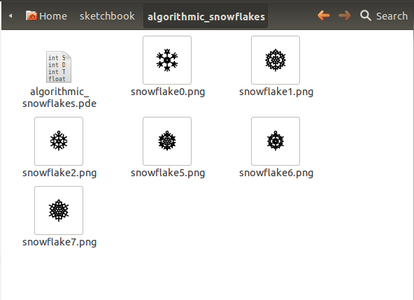

Step 2: Generate Snowflakes

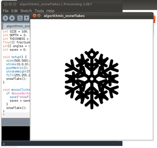

Run the sketch using Processing. A window will pop up displaying a randomized snowflake. Clicking on the image will save that image to the sketch folder and generate a new snowflake. Click as many times as you want to continue generating more snowflakes.
Note the parameters SIZE, DEPTH, and THICKNESS, in case you want to change these. SIZE affects how big the snowflake is. DEPTH determines how many times the fractal-like algorithm iterates, which affects how intricate the snowflakes are. THICKNESS affects the thickness of the branches.

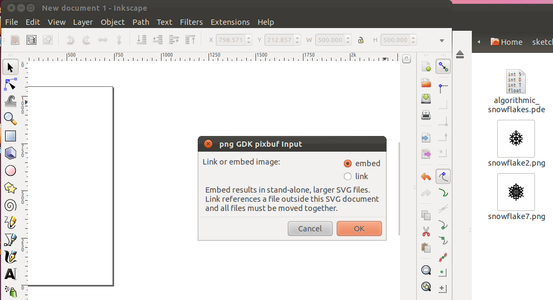

Step 3: Embed the Images in Inkscape
Open a new document in Inkscape. Drag the snowflake *.png files from the sketch folder onto the Inkscape document. Inkscape will give you the choice of either embedding or linking to the images. Choose "embed."

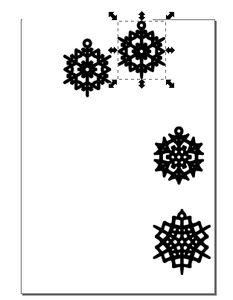

Step 4: Convert the Images to Vectors
Currently the snowflakes are bitmapped images, but in order to laser cut them, we need to convert them to vectors. Select one of the snowflakes you wish to laser cut. Choose "Trace Bitmap" from the "Path" menu. Click "Okay" in the window that pops up, and then close the pop-up window. This creates a vectorized copy of the snowflake you had selected. Drag the vectorized snowflake away from the bitmapped original, and then delete the original.
Repeat this process for all the snowflakes you wish to laser cut.

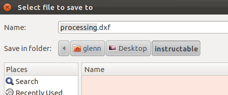

Step 5: Save Your Work and Laser Cut the Snowflakes
Save your work in a file format recognized by the laser cutting software you plan to use. Many laser cutters recognize *.dxf files. If you reopen the *.dxf file using Inkscape, it is clear that the snowflakes are now vector graphics.
