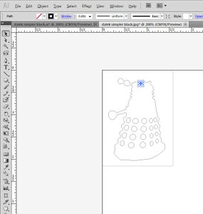

Open image and Live Trace
1. Open the image in Adobe Illustrator
Open > click on image > open
2. Select the image by clicking on it with the arrow, it should have a blue box around it
3. Locate Live Trace on the control panel and click on the arrow to the right, choose black and white logo from the pull down menu.
4. Select your image then click Expand in the tool bar, your image should now be outlined in blue with blue squares

Change the colors and define the lines
5. Open the color palette in the right tool bar
6. Yous should see two boxes, one with a question mark and one with a box in a box. Selected the box in a box and click black. Select the box with the question mark and then select no color by clicking on the white box with the red slash, you should now have a dalek with black lines and no color.
7. If you are cutting this at TechShop the stroke needs to be 0.001. Fill that in in the upper tool bar.

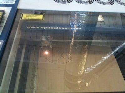

For this step we are using 1/8 inch acrylic.
1. Take the TechShop SBU for the Epilog Laser
2. Set the focus and home position on the laser.

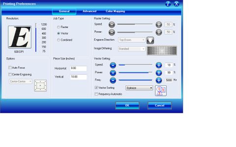

3. In the printing preferences set vector settings. I used Speed 18/ Power 90/ Frequency 5000. Click Print
4. Hit the green go button on the laser
5. Watch your laser to be sure nothing is on fire.
6. If the pieces have't cut through don't move the piece, just run the print again to cut more.

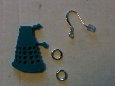

Make your plastic pieces into jewelry

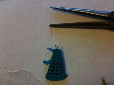

1. Jump rings function by twisting, not pulling apart. Grasp your jump ring in two pairs of pliers and twist your hands to open the ring. Each side should go past each other, not opening up like a clam.
2. Thread the hole in your earring onto the jump ring. Thread the loop on your earring hook through the jump ring. If the plastic piece is hanging in the wrong orientation you may need to have two jump rings between your plastic piece and the earring hook.
3. Twist the jump ring closed.
