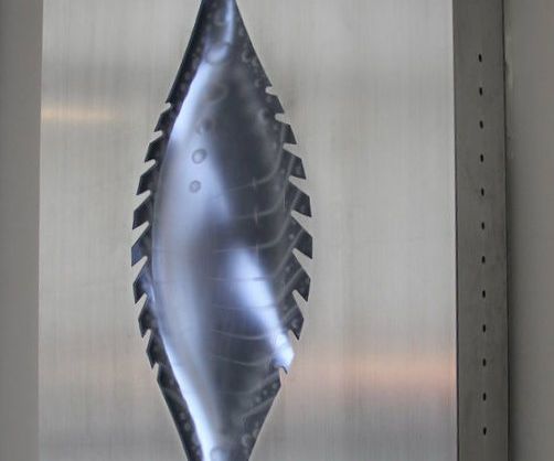

Here is a frosted acrylic lamp shade that fits on an Ikea light cord. The design is something between a flower and a klingon bat'leth, just like you always wanted. You're welcome.
This instructible focuses on the design process, but I've also included the file so you can build your own!

I sketched some curves in my notebook, then traced them in Rhino. I used the edit points to adjust the curves, you can see the iterations. I then scaled the curve to the size that I wanted, less than 1 foot by 2 feet. I modeled a standard light bulb for a sense of scale and proportion.
Step 2: Design the Light Fixture Mount and Output the Laser Cut File
The profile curves will attach to each other and the light fixture via some notched rings. Here's a previs of what the lamp design is so far.
This lamp shade is designed to fit the Ikea Hemma 15' light cord. The interior diameter of the rings needs to be wider than the threads of the fixture (measurement A) but smaller than both the screw attachment (B) and it's stop point (C). The exterior diameter needs to be wide enough to accommodate the profile joint/notches and clear the attachment (B). I decided on 1 5/8th" (1.625") for the interior diameter and 3" for the exterior diameter of the ring.
This is designed for 1/8" acrylic, so that's how wide our notches will be. Don't worry about leaving a tolerance: acrylic sheets are actually a little thinner than their list dimension. Also, the laser cutter makes the cut slightly wider. 1/8" notches give us just the right amount of play for assembly. Finally, I add little slits for the vellum shade pieces to go in. They are only 1/32" wide.
Set the lines you want to cut with the laser to red (exactly red, not just any red). Set any lines you want etched to blue, and guidelines to yellow. Repeat the parts and layout the design to fit the sheet of material. I got the design to fit within a 24" x 16" rectangle and cut the design from a 32" x 16" sheet. Export the Rhino file as an Autocad (.DWG) file. I set the output to 2004 Polylines. The Rhino and DWG files are attached.
