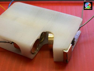

Step 5: Machining the Block Part 3
Now the holes for the motors were drilled and slots were cut all around for the battery, magnet, pot, switch and driver circuit.
Photos show the motor units fitted, third photo shows the magnet that holds the zippo lid closed.

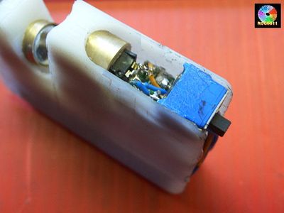

Step 6: Assembly and Wiring Part 1
Pictures shows the driver circuit in place, followed by the on off switch fitted.
A small hole was then cut in the zippo case to access the switch.
