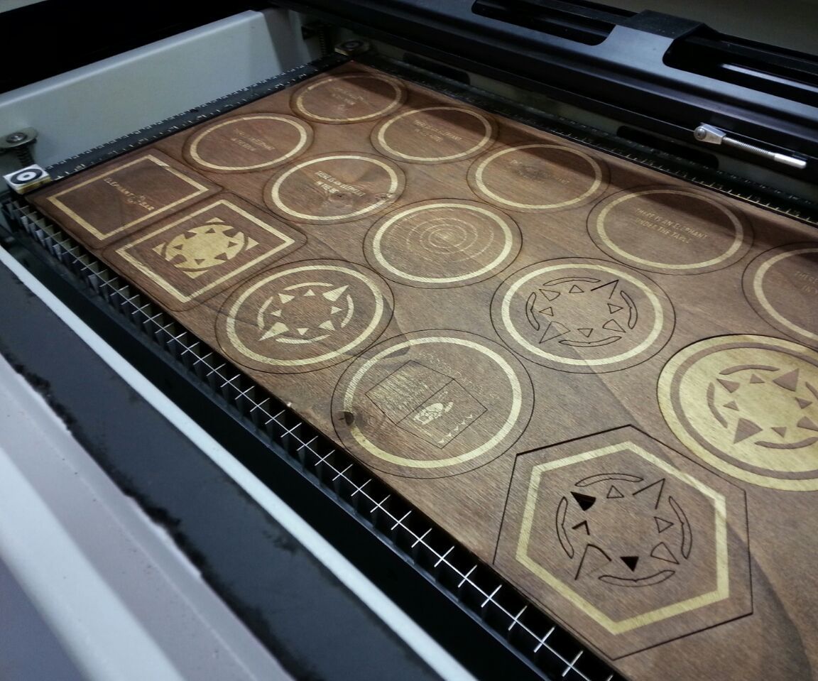

Step 5: Lasercut and Glue It !
Cut it out with your laser of choice. I used the software Visicut by T. Ostermann it is very intuitive.
You can varnish the pieces now or before it doesnt really matter. Just be sure to use waterbased acrylic varnish if you used solvent stain .
If you have mounting holes then use them ! Put A frame around it or cover it with glass !
