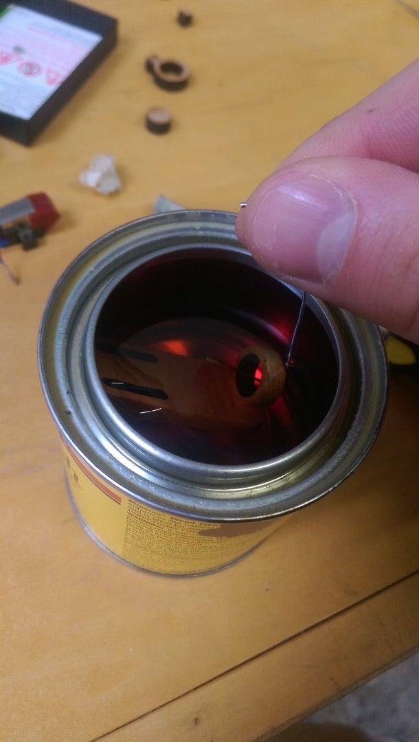

Start with some wood stain. I used Minwax Wood Finish 209, Natural Color, cut with just a little lacquer thinner. Dip it in and pull it out. Remove any excess drips with a rag. Let it dry, go get a beverage!
I did this 3 times, until I got the rich color I wanted. Follow the directions on your stain and wait about 8 hours between applications. Wet sanding with 600 grit between applications helps get a nice smooth coat. If you are a perfectionist get out the 1200 grit and go to town before the last coat.
I finished it off with some wood oil after the stain had dried for about 24 hours.
