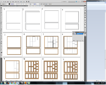

Open your vector graphics program and begin drawing your boxes
Step #1: First draw two boxes one above the other, one that is the length(8&3/4") and width(5&3/4) you have selected for your external box, and the other that is the length(8&3/4) and the depth(3") that you have selected for your external box
Step #2: duplicate the first two boxes
Step #3: position them directly over the original boxes
Step #4: Subtract twice the percise material thickness from both the width & height of both boxes, In my case using illustrator I can do this by simply typing after the existing value a "-"(minus sign) followed by the amount to subtract, and in addition the boxes will remain centered if they dont remain centered re-center them
Step #5: set the fill color of the larger box to a color that will represent your material for ease of visualization

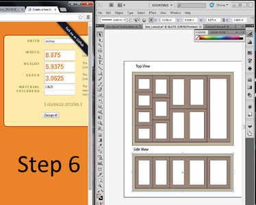

Step #6: Draw your internal boxes to aproximately the dimensions you have selected inside white internal box of the external box on the top of your screen, this will represent the top view of your nested boxes
Step #7:Adjust the sizes of your internal and external boxes until the internal boxes fit fit exactly within and fill up the entire area of the white space external box they reside in and are roughly the desired size
Step #8: draw lines from the edges of your top view's internal boxes down through the side view below so, then
Step #9 draw internal boxes in the side view that fit exactly between these lines
Step #10 just as you did with the external box, duplicate all internal boxes, lay them over the originals, and subtract from each precisely the material width, then fill in the outside copies, you now have a diagram of what your final box will look like
Step #11 expand your external box, both the interior and exterior box by 1/16" of an inch, or so to create tolerance insuring your internal boxes a good fit. DO THIS WITH THE TOP AND SIDE VIEW, AND EXPAND BOTH THE WIDTH AND THE HEIGHT

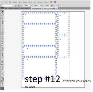

Step #12: CHECK YOUR LAYOUT. do this by creating a small box that is exactly the thickness of your material, in both height and width and placing it in the corner top right hand corner of the colored external box, it should come exactly to the corner of the white box inside, duplicate this and put one on the bottom right corner, followed by the top left and bottom right corner of all inside boxes if you want you may also number your internal boxes and later transfer these numbers as raster images to your box vectors for ease of locating what pieces belong to what box. I did not do this but I wished I had during assembly.

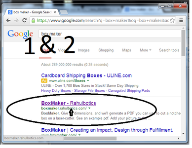

Step #1 Open your web-browser and go to google.com, type Box maker in the search bar
Step #2 Click on the "BoxMaker - Rahulbotics" link in your browser

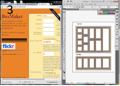

Step #3 Size your vector graphics program and your web-browser so they can be arranged side by side or one below the other on your screen

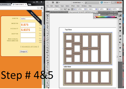

Step #4 Select your exterior box's shaded outer box in the top view
Step #5 Copy the height and width of that selected box into the height and width text boxes in the box-maker page
Step #6 Select your exterior box's shaded outer box in the side view and enter its height in the depth text box

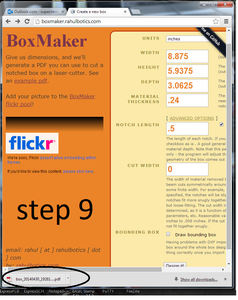

Step #7 Measure the precise thickness of your material preferably with calipers if you have access to them and enter it in the material thickness box on box maker
Step #8: In the advanced section of the box maker dialogue make sure that the thickness of the joints is ideal for hinges preferably around 3/8"
Step #9 Click the "Design It!" button at the bottom of the box maker page

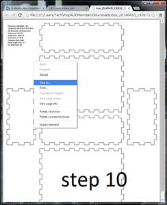

Step #10 Open the resulting P.D.F and save it in the folder you will be using for your box files
Step #11 Open the P.D.F you have just saved in your vector graphics program
Step 12 delete the text generated at the top, Group or join each box face , then arrange the pieces as you want to laser them on your material eg. as close together as possible. also if you are not a fan of puzzles you ( in the demo picture, the tiny text you will see in the box faces is an example of raster labeling your box pieces to keep them from getting mixed up )
