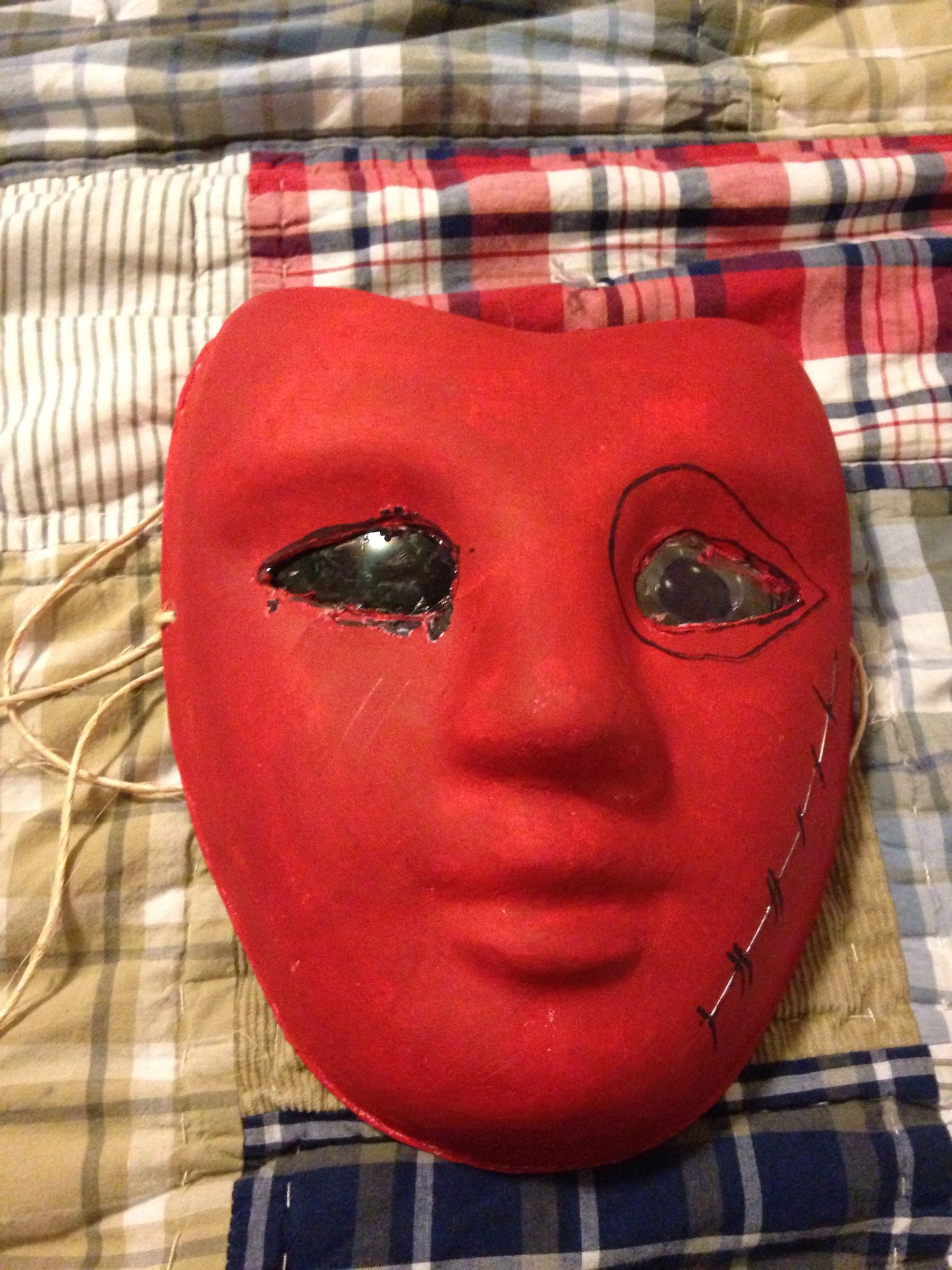

Once your mask is off the sculpt trim the edges and cut out the eye holes to make it look nice
An exact I knife works best
Step 9: Enjoy
Now you can admire your work
And if you choose to you can add a strap or when you are going to wear it say Halloween you can use latex to attach it to your face then peel it off when you are done.
