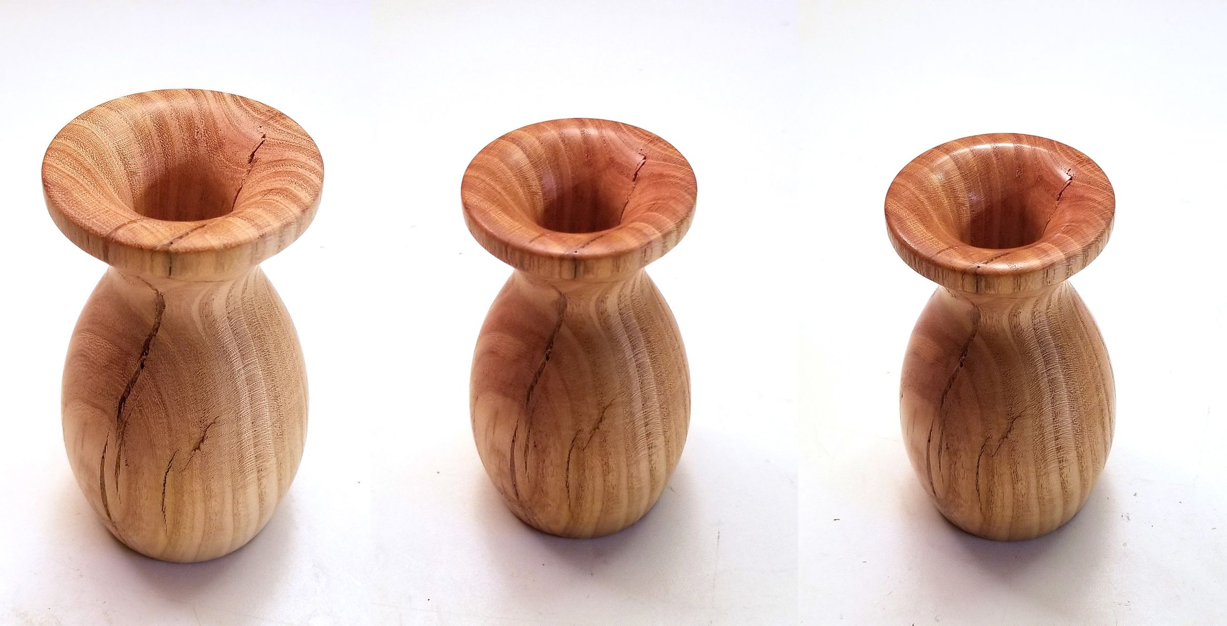

Step 11: Make It Shine!
This image shows what a dramatic effect buffing your project can have. It compares bare wood, danish oil, and after the buffing process.
Be sure to wear proper PPE as buffing compound is an abrasive. Probably not a good idea to breathe it in or get it in your eyes.
To buff wood, you want to start with a clean buffing wheel. Use a scrap piece of wood to scrape off old buffing compound. Apply an ample amount of tripoli compound to your first wheel by rubbing it on while the wheel is moving. Buff the wood on the underside of the wheel. This will keep it from being thrown at you if you happen to lose grip. Always keep the wood moving to reduce heat building up and burning the wood. Once you have buffed the entire piece, take a natural bristle brush and scrub the piece (especially if it has cracks or voids like this vase does). This will remove all excess buffing compound to avoid cross contamination from wheel to wheel. Repeat the same process with white diamond buffing compound on the second wheel.
For the final wheel I used carnauba wax. This wax is perfect for high gloss finishes like this because it has a high melting temperature and is hard compared to other waxes like beeswax. Apply wax to the wheel the same way as the previous wheels, however you want to pay attention when you start buffing. Wax will smear if you apply too much to the wheel. If you are noticing wax building up on the wood, scrape off excess wax from the wheel with a piece of scrap wood and start over applying less to the wheel.
