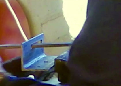

I used 2 pieces of 2 x 2 angle iron 3mm thick to make the new mounts.
After marking the holes with a scribe I drilled 2 x 6mm holes parallel to each other for the bolt sliders and 3 hole equally spaced for fixing screws on each mount.

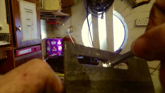

I cut the bolt slider holes with my jigsaw and cleaned them up with a file the slots need to be fairly accurate to except the square ends of a coach bolt so that they don't turn when tightening.

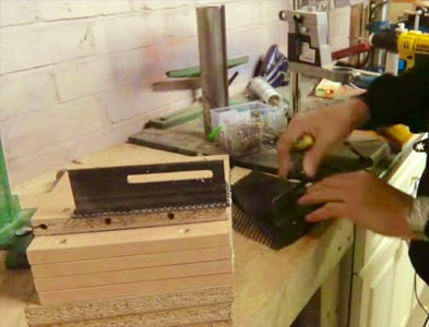

Step 2: Building the Motor Pedestal
I used 3 layers of particle board to bolt the lathe bed down and another 5 layer for the motor pedestal I ( I figured the more layer less vibration) isolated the last layer by inserting a rubber mat under it and 2 layers of rubber mat under the motor mounts.
I wrapped a block of wood slightly higher than the metal angle in the same material so that the motor sat on this rather than metal to metal

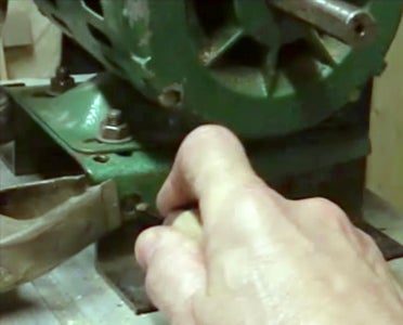

Step 3: Mounting the The Motor
The motor sit on the mounting brackets and slides in the slots for belt tension and held firmly in place by 2 coach bolts and 2 home made screw down knobs.
