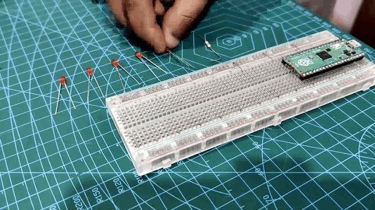

These were the materials used in this project.
  1. Custom PCB (Provided by Seeed Studio Fusion)
  2. Header pins male
  3. LEDs
  4. Breadboard
  5. jumper wires
  6. 1K Resistor through hole 1/4W
  7. LattePanda 3 Delta Setup (Screen, Keyboard, mouse, etc)

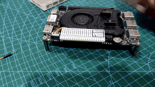

Analyzing the breakout diagram of the headerpin of the Latte Panda 3 Delta was our first step in the PCB design process.
We created a schematic that included two CON15 header pin connectors on either side of the CON30 header pin (15 pins on one side and 15 on the other).
Additionally, we included a CON20 header pin, which breaks out every I/O pin on the Atmega32U, including 5V and GND, and from D0 to D23.

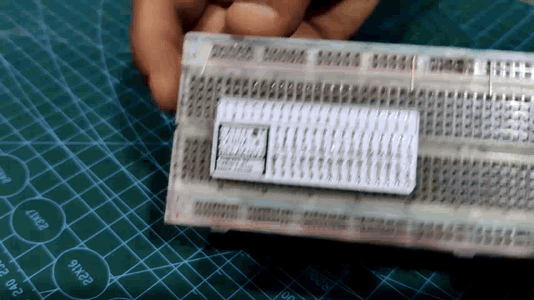

The CON30 header pins were then placed in the center of a board, and the CON15 pins were placed on the left and right sides of the CON30 header pin connector. On one side of the board, we have further incorporated the CON20 header pin connector, which serves to link the breakout board and breadboard.

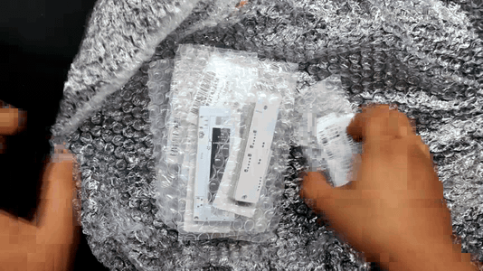

Step 3: Seeed Fusion PCB Service
An order was placed for a white solder mask with black silkscreen.
The quality was super good considering the rate, which was also pretty low.
Seeed Fusion offers one-stop prototyping for PCB manufacture and PCB assembly, and as a result, they produce superior-quality PCBs and fast-turnkey PCBA within 7 working days.
Seeed Studio Fusion PCB Assembly Service takes care of the entire fabrication process, from PCB manufacturing to parts sourcing, assembly, and testing services, so you can be sure that they are getting a quality product.
After gauging market interest and verifying a working prototype, Seeed Propagate Service can help you bring the product to market with professional guidance and a strong network of connections.

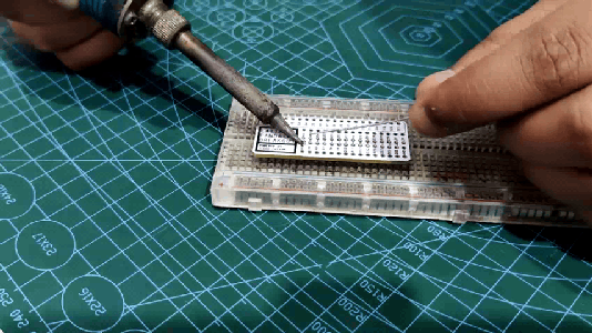

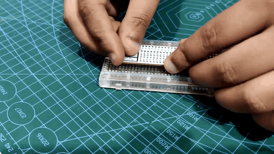

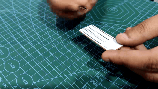

  1. Male header pins are the first to be added to the PCB assembly process. Since we did not have header pins that were precisely the right length, we joined two of them to make one that was longer.
  2. In order to ensure that the pins will not bend during soldering, we placed the breakout board on a breadboard before soldering the pins.
  3. We use a soldering iron to secure the pins in place.
  4. PCB Assembly is now completed.

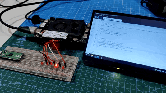

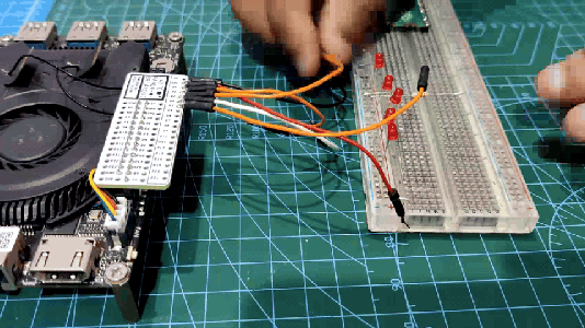

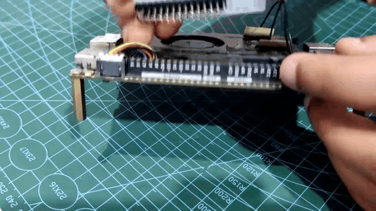

  1. We insert the breakout board into the Lattepanda's header pins in the correct order to test this arrangement.

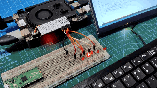

  2. The next step is to set up the LED testing setup, which consists of five 3mm through-hole LEDs placed on a breadboard. The negative of each LED is connected to the negative of the other LEDs, and a 1K resistor is added. The GND of the Latte Panda is connected to the 1K resistor, allowing current to flow through it.
  3. Six jumper wires were now connected to the breakout board's D0, D1, D2, D3, D4, and GND pins.
  4. GND will be linked to a 1K resistance, and all of the Latte Panda's I/O pins, D0 through D4, will be connected to the positive terminals of the five LEDs.

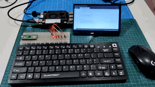

  5. We created a basic chaser sketch using the Arduino IDE and uploaded it to the Atmega32U by first choosing the Arduino Leonardo board in the board manager and then the COM port, which was COM3.
  6. Once the code was uploaded to the Atmega32u, an LED chaser sequence began to run, indicating that the setup was successful. With the Atmega32U that was provided, we may now connect a variety of devices to the Lattepanda.
