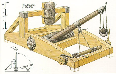

This is technically an [http://en.wikipedia.org/wiki/Onager_(siege_weapon) onager] but it is still in the catapult family.
