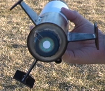

For this tutorial I am adding built in ignition to a T-Loc 2.63 from Loc Precision, but many other model rockets will work just fine. The electronics payload will need to fit inside the nose cone of the rocket with some bubble wrap for protection. The ignition cable will run the length of the inside of your body tube and pass between your motor tube and the body tube. The electronics payload and ignition hardware will add an additional ~50 grams to the total weight of your build. For these reasons, I suggest building a rocket that is 2" in diameter or larger, so there is room for the payload and ignition cable. I have never used this setup on anything smaller than an estes D size motor, but I think its possible to go smaller if you wanted to try it.
The T-Loc 2.63 fits the bill for this build. I like that it has sturdy wood motor mounts and fins that go through the slotted body tube to interlock with the motor mounts. This makes for a very sturdy construction and doesn't have you doing a balancing act trying to glue square fins to a round tube.

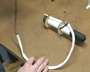

For the most part, you will follow the normal build instructions for the kit. The only difference will be putting in some 5mm holes in the wood motor mounts so you can feed the ignition cable through the entire length of the body tube. Because you will be feeding the ignition cable and shock cord through a length of protective 8mm fiberglass sleeve, it makes sense to put the ignition cable hole near to where the shock cord will be secured to the upper motor mount. Make sure the holes are aligned to one another when gluing up the motor mounts.
The ignition cable is in two pieces, the shorter length will be secured to the nose cone and the longer will be secured to the motor mounts. The longer section of ignition cable has dupont connectors without plastic covering at one end. This is the end that should be used to connect to the igniter because plastic covers might melt during launch being so close to the motor exhaust. Cut a length of 8mm fiberglass sleeve to shield the ignition cable in the section between the upper and lower motor mounts and feed the ignition cable through the assembly. You don't want an excessive amount of ignition cable sticking out the bottom of the rocket, but you need to make sure the igniters can easily reach the connectors as well. I install a motor and igniter into the motor tube and connect the igniter to the ignition cable. This will hold everything at the correct location so you can secure the ignition cable and protective fiberglass sleeve at the upper motor mount with CA glue. You want to completely fill in the upper motor mount hole with CA glue so you don't change the pressure characteristics of the rocket, which might effect the reliability of the parachute ejection charge. Cut the 2.5mm fiberglass sleeve to ~1" lengths and slip them over the exposed dupont connectors and through the lower motor mount hole. Secure everything at the lower motor mount hole with CA glue.
Feed the shock cord and ignition cable through the remaining length of 8mm fiberglass sleeve. I taped the shock cord to the plastic connector at the end of the ignition cable and simply fed it through the sleeve, but there may be more clever ways to do that. I soaked some CA glue into the ends of the fiberglass sleeve and hit it with activator in order to prevent the sleeve from fraying. Install the motor mount assembly and fins as normal.
Open a ~1.75" hole in the side wall of the nose cone. A drill press and hole saw works well for this. The nose cone that comes with the T-Loc 2.63 already has a hole at the bottom that allows you to feed in the upper section of ignition cable and secure with CA glue. Make sure you leave yourself long enough leads to make it easy to connect the ignition cable to the electronics payload outside of the nose cone. I pack the top ~2/3 of the nose cone with bubble wrap. When I am packing the rocket for launch, I connect the ignition cable to the electronics payload and then wrap the payload in some bubble wrap and pack into the nose cone, then add some more bubble wrap to keep the payload more or less centered in the nose cone. I use kapton or painters tape to cover the nose cone access hole. Make sure the nose cone still slides smoothly into the body tube. Wrinkles in the tape may make it too tight, which will prevent your parachute from deploying reliably. You may need to sand down the nose cone or the inside of the body tube so you have a good fit.
Glue on the launch rail guides. I like using the 3D printed ones because they have a curve that matches the diameter of the body tube so there is better surface area in contact with the body tube, and they are easy to set in place during glue up. I use the launch rail to hold the rail guides in line with one another while gluing to the body tube. Add some paint and you should be good to go!
