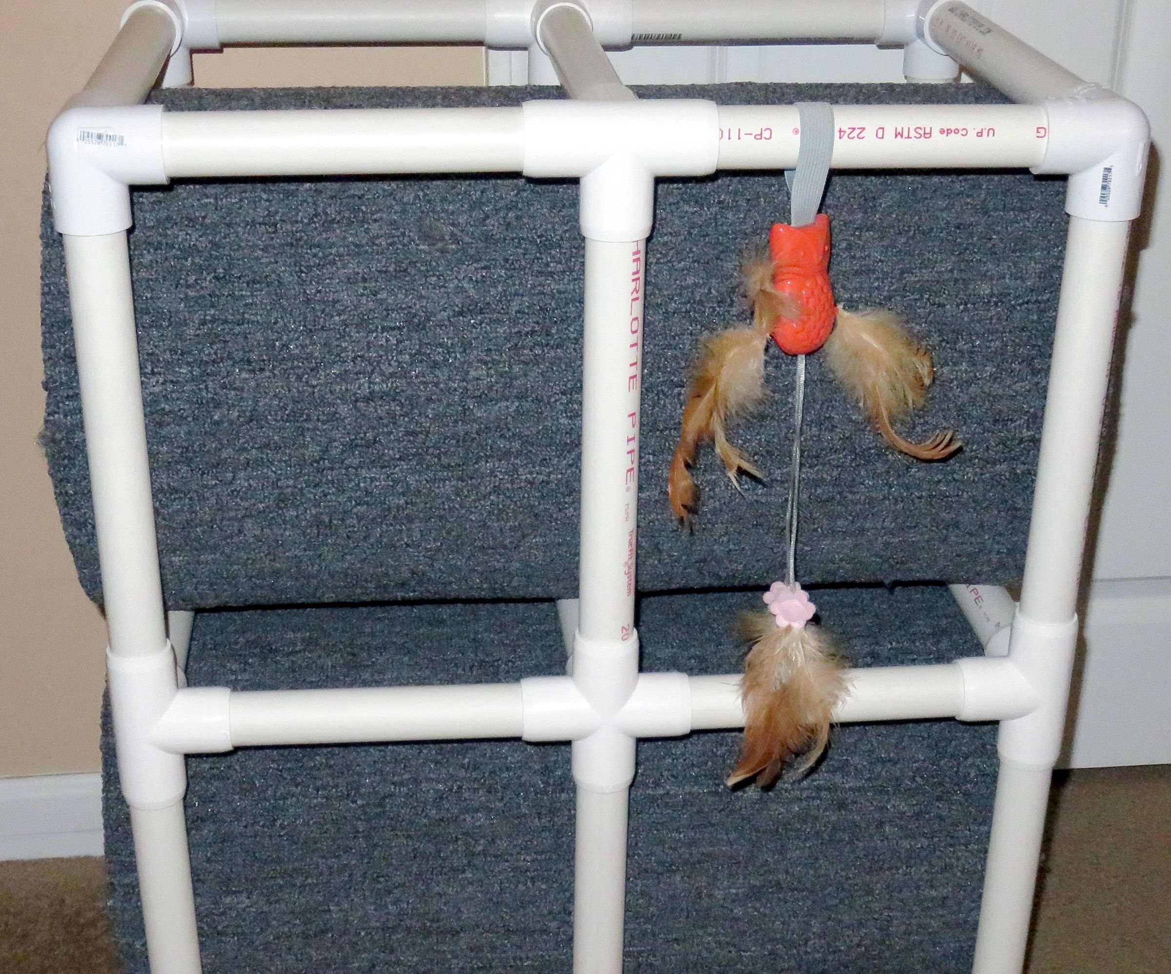

Connect the PVC pipes and Fittings. See photo for correct orientation of Fittings and location of PVC pipe sizes.
Step 4: Build the Unit
Attach (4) 15” PVC Pipe to top of the 3-Way PVC Elbow Fitting on the bottom layer (see photo)
Step 5: Build the Unit
Place the Middle layer on top of the (4) 15” PVC Pipes from the Bottom layer. (see photo)
Attach (4) 15” PVC Pipe to top of the 4-Way PVC TEE Fittings on the Middle layer. (see photo)
Place the Top Layer on top of the (4) 15” PVC Pipes from the Middle layer.
