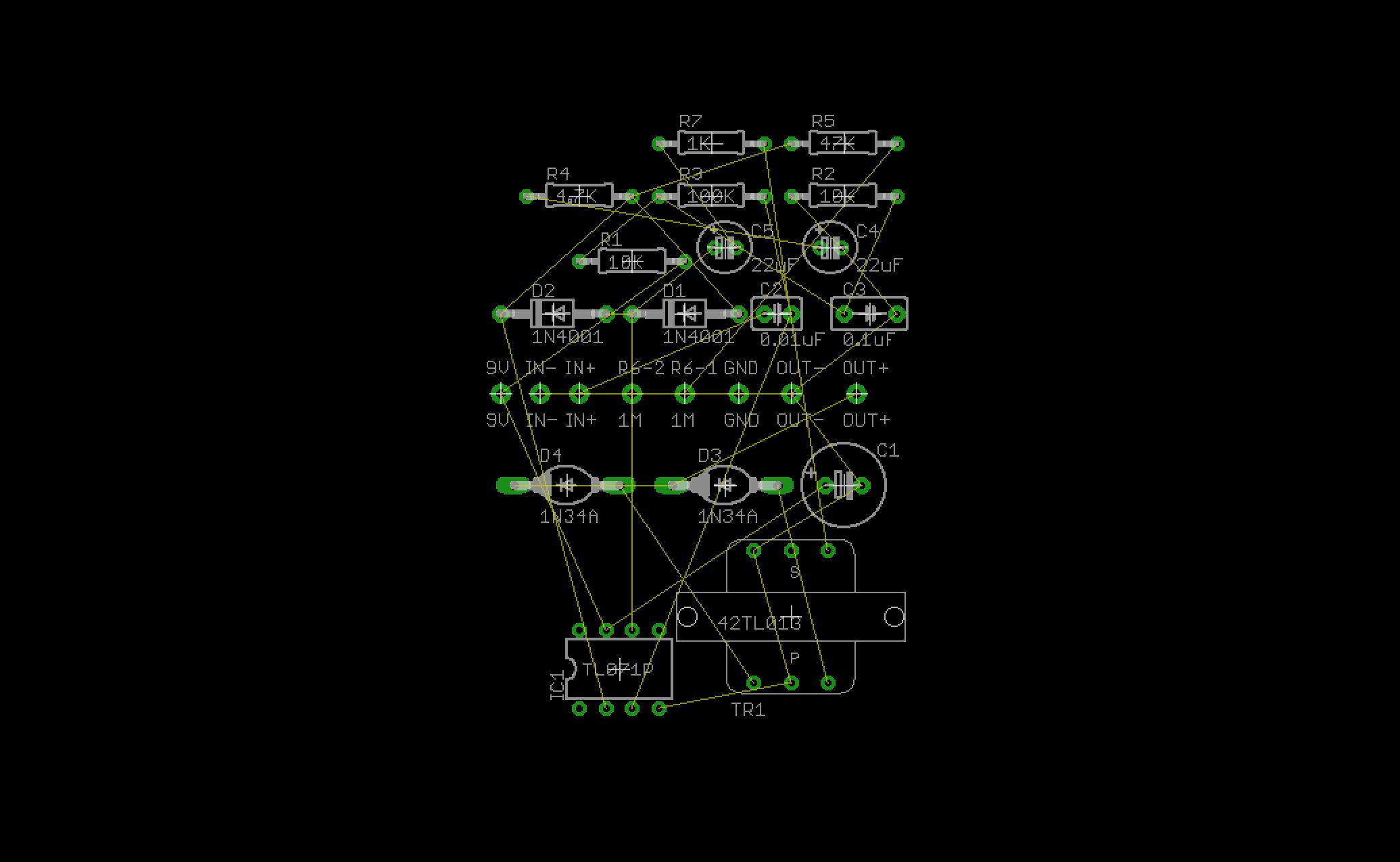

Once the board file is generated, it is time to arrange the components' footprints on the board. The idea is to keep the distance between the different footprints as short as possible. On one hand, it is good to avoiding placing the components so close that they are on top of one another because it will make it more difficult to assemble later. On the other hand, the larger the board is, the more it will cost to manufacture.
You should be starting off with a jumbled mess of components and airwires. These are thin "rubber band" lines which indicates two points that require a circuit connection be drawn between them. When you move the parts around, these lines stretch or contract like rubber bands.
This jumble also has a name. It is called a ratsnest. I am honestly not 100% certain why it has such an unpleasant name, but I suspect it has something to do with looking like a nest a rat would (or something unequally unpleasant) would make. At the very least, someone was having a bad day when they decided to call it that.
Our first order of business is to use the move tool to place the footprints spread out upon the board. You need to place the footprints within the frame of the board or the software will give you a really annoying pop-up telling you that you cannot place a component there.
To begin with, don't worry about placing them in the correct position. Just get them spread out and take inventory. Once you have a grasp on what goes where, then you can begin positioning them on the board.
The goal in placing the footprints is to try to keep airwires from twisting, overlapping, or traveling great distances. The easiest way to do this is to place components which get wired directly together next to each other.
However, you are eventually going to get to a point that no matter what you do, you have a mess of twisting and overlapping airwires. In fact, you may look at your airwires and think many of the connections don't even make sense and should be drawn differently.
Fortunately, there is a secret weapon for redrawing the airwires and cleaning up your connections. You simply press the "Ratsnest" button on the bottom of the left-hand toolbar (the button that looks like a wooden molecule model). When you press this you will be delighted to discover that the airwaves get redrawn with more direct paths. This will allow you to continue to move the components around, and simplify the circuit connections even further.

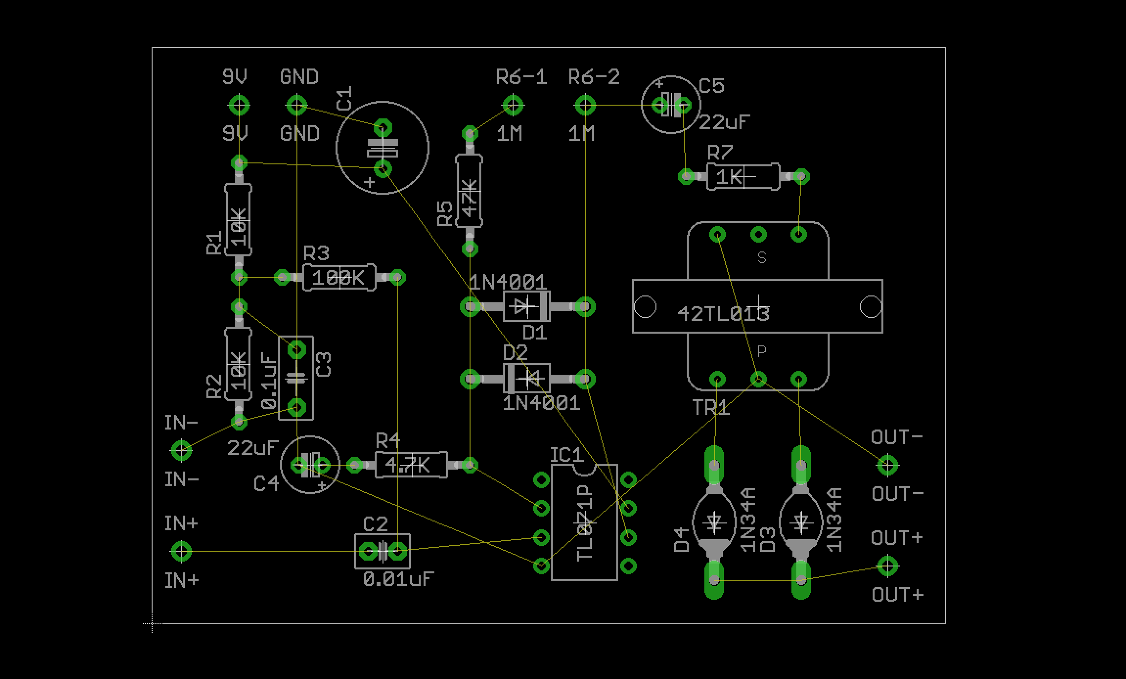

Once you start to have a grasp of part placement, move the circuit towards the bottom left-hand corner of the board. Then, adjust the board outline to fit your circuit (typically shrinking it) by clicking and dragging on it using the move tool. However, don't move the bottom left-hand corner of the board. This corner is currently on the (0,0) position and this will be useful later in easily determining the board size.
Continue compacting the board until the components are packed in fairly tight.
I can probably compress the parts in this example even tighter, but I think keeping them a little bit spread out will make it easier to route traces.

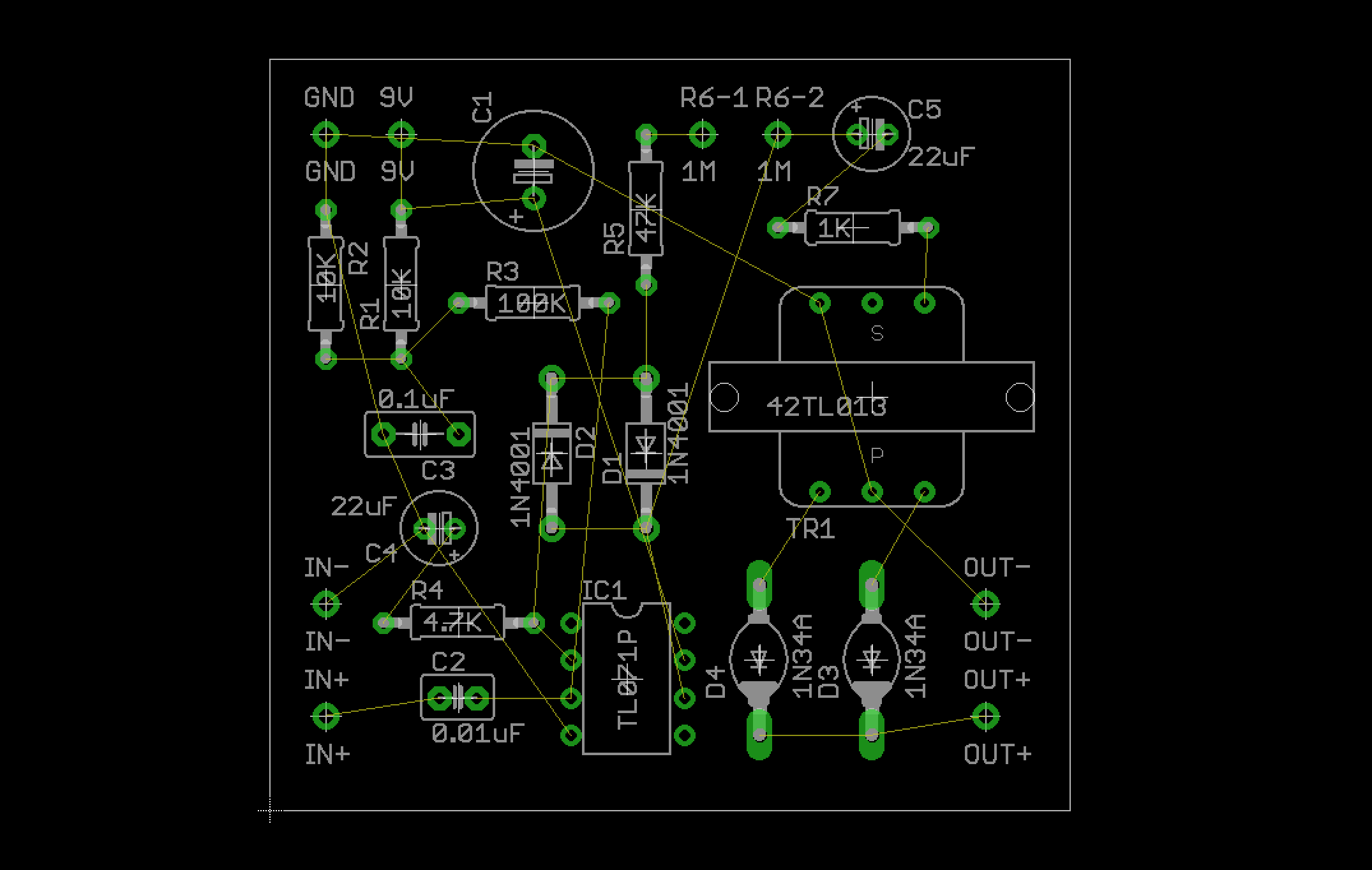

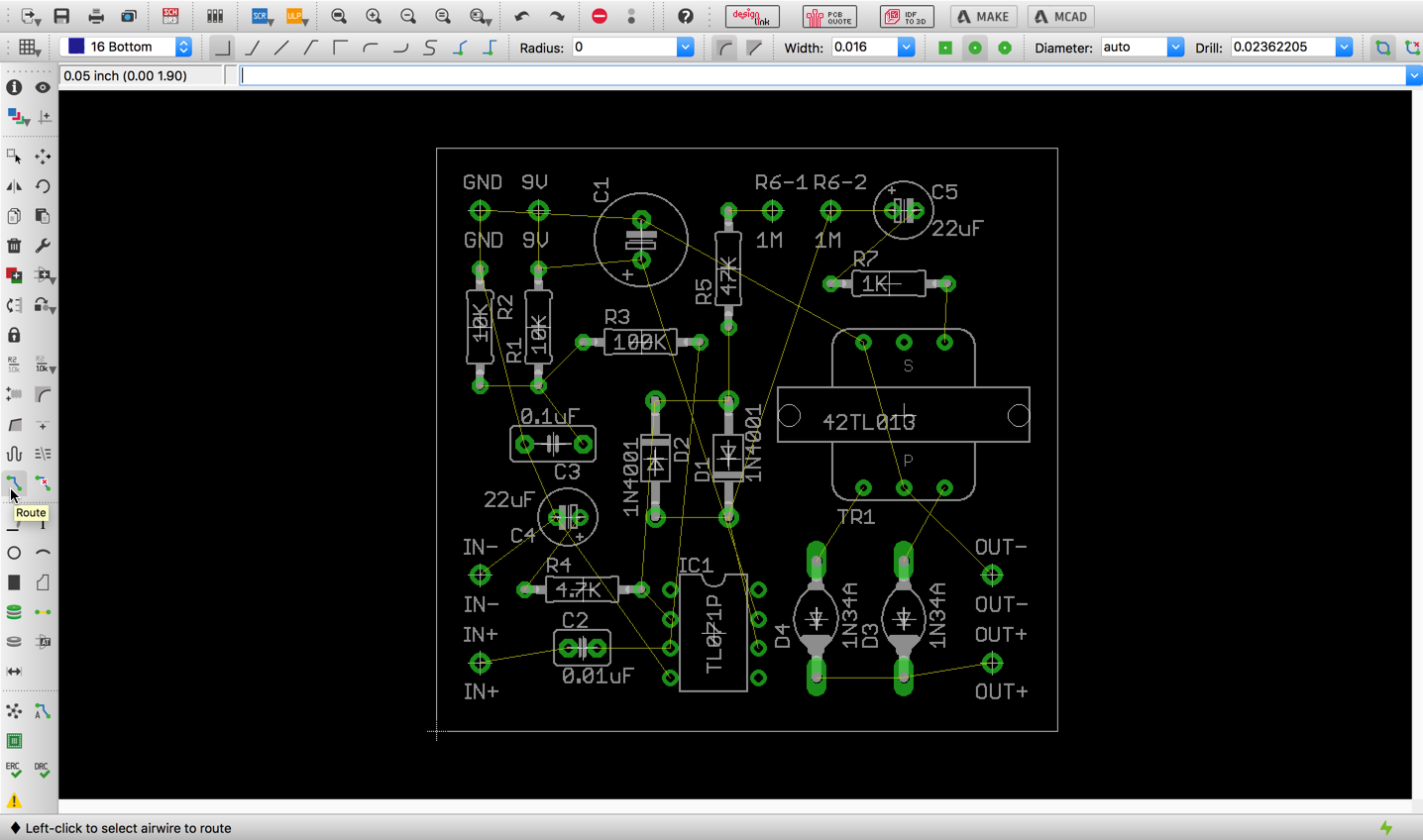

To create your first trace select the "Route" tool on the left-hand side tool menu. It is the one which looks like a blue squiggle with green dots on the end. You will notice that when you select it you get a new toolbar on the top of the window. These new settings are important to be mindful of.
Let's look at the left-hand side of the tool-bar. The first thing you will see is a layer drop-down menu. We are going to select layer "16 Bottom" to begin. It doesn't particularly matter if you draw traces on the top or bottom of the board, but for argument's sake, let's draw them on the bottom.
Next to the drop-down menu, you will see a series of squiggles. These indicate different ways in which lines can be drawn between points. We'll come back to these in one moment, but first, I want to point out the "Width" drop-down menu. This specifies the width of the copper trace you are creating on the board. I keep mine set at a width of 0.016 which is more than enough for any low-current application. If your traces are going to be carrying high current (such as an amp or more), you will want to use a trace width calculator to make sure your traces are large enough to handle it.
Anyhow, the different squiggles at the top allow you to draw different angled lines. The curves that have right angles are good for drawing traces which are straight lines or connections which meet at a right angles. The ones which are diagonals are used for drawing diagonals. The curved lines are good at drawing — you guessed it! — curved lines. For the most part, this isn't rocket science.
The two colored squiggles, however, require our special attention. These are the "follow-me" paths and allow us to auto-route traces between two points that are connected by airwires. By clicking on the starting location and moving the pointer around, you can slightly adjust the shape and location of these routes. I prefer to use the option on the right-hand side which tries to figure out the best path "from both sides."
This tool is extremely useful for complex paths that swerve around other parts and traces. It is also useful for routing paths that require vias.

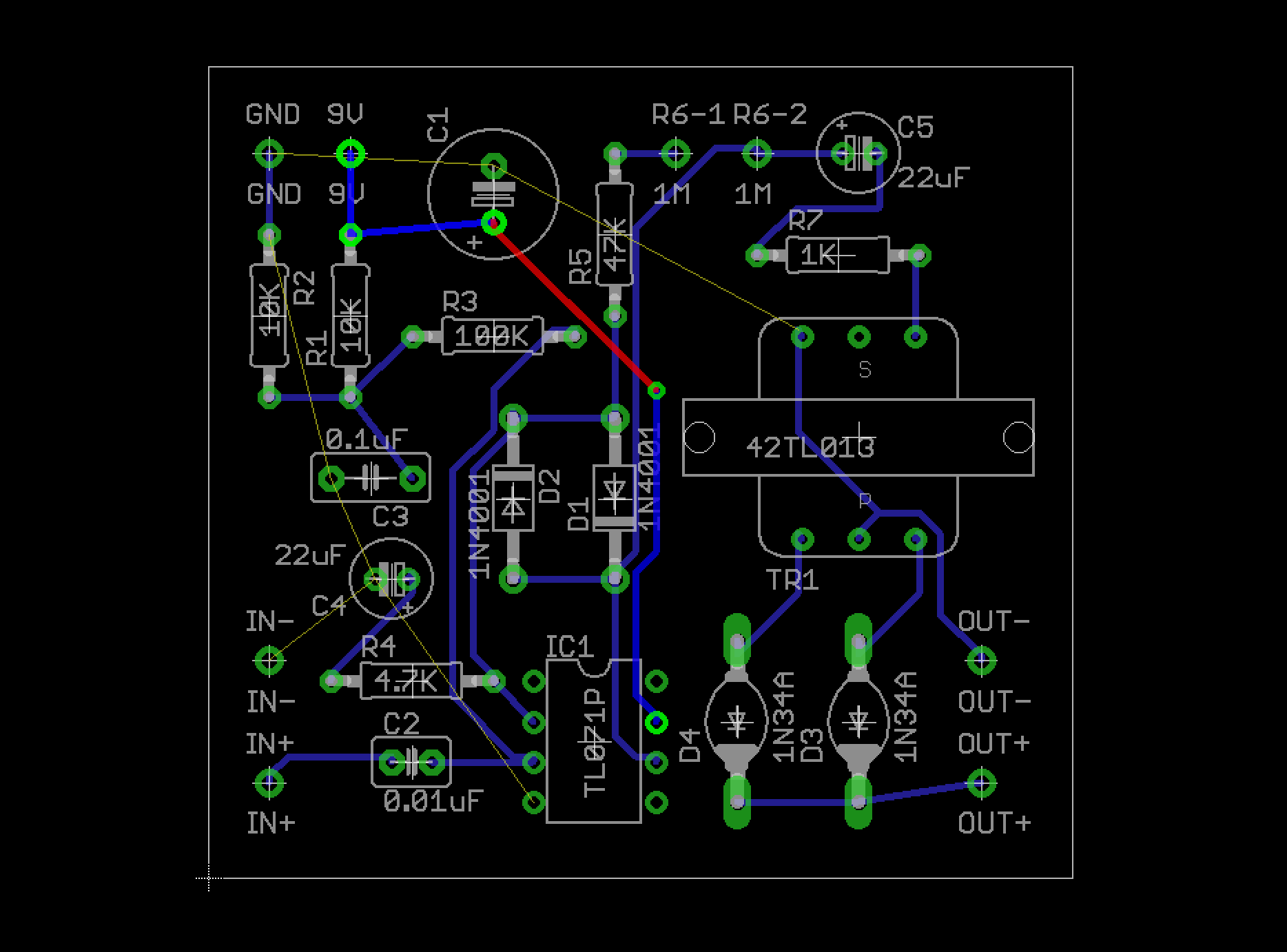

If for some reason you mess up and need to remove some traces, you can use the "Ripup" tool. In the above image I'm removing all of the ground connections that I had previously drawn because I have new plans for connecting all of the ground connections to the circuit.

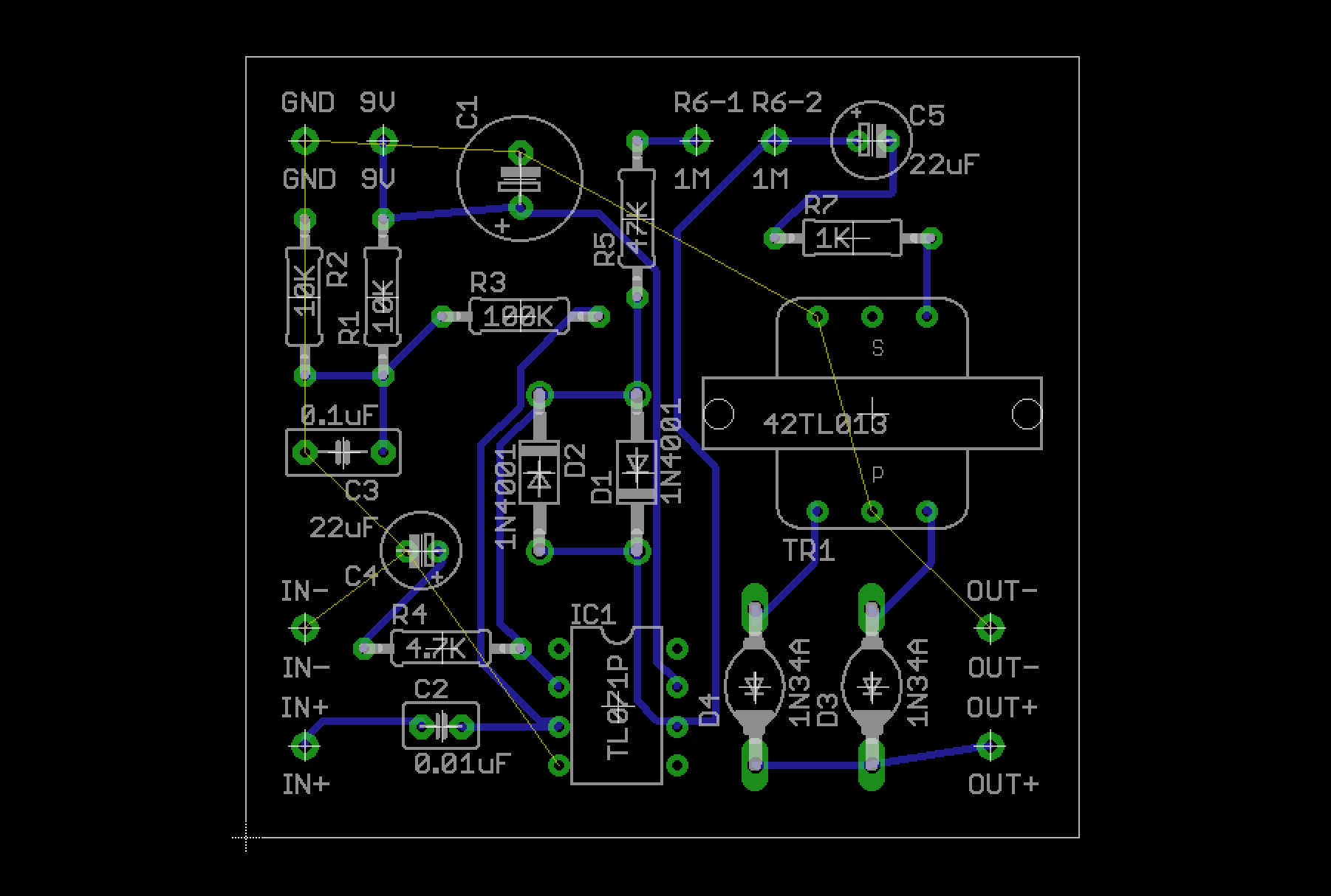

Thanks to some creative routing, it turns out I didn't need to use the via after all, and was able to keep all of my traces to the bottom side of the board. The board now is mostly done. Notice that the only airwires not connected are the ground wires. This is on purpose. Rather than figure out how to route all of these wires, I'm instead going to add a ground plane.

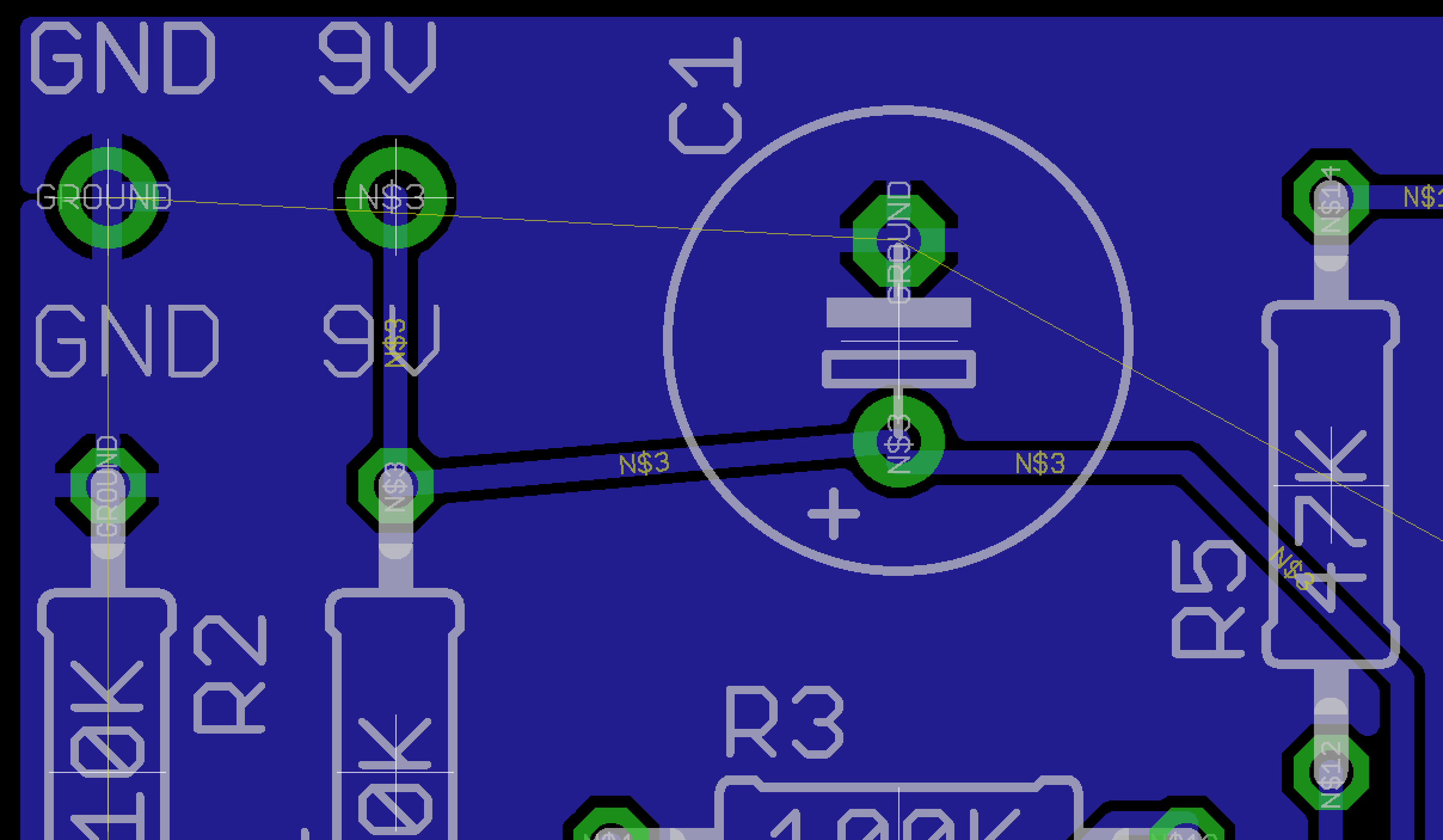

Select the "Polygon" tool which looks like a rectangle with a bite out of the top corner from the left-hand toolbar. In the top toolbar make sure the layers is set to "16 Bottom" and then change the isolate setting to 0.012. This number means that there will be 0.012" of space between the all of the copper connections and the ground plane.
Trace the outline of the board with the polygon tool. When complete, you will see a dotted line form around the outside of the board.
Rename this dotted outline "GROUND" using the Name tool.
Finally, click the Ratsnest tool to draw in the ground plane.
Now is the moment of truth. We are going to connect the ground plane to all of the circuit's ground pins.
Click on any of the ground airwires using the Name tool. Something akin to "N$2" should show up as its name. Delete this and rename the pin "GROUND."
All of the pins connected to the "GROUND" airwires should now be connected to the "GROUND" plane. Zoom in and review these pins to confirm there are little blue lines connecting them to the ground plane. It's a bit like magic.
