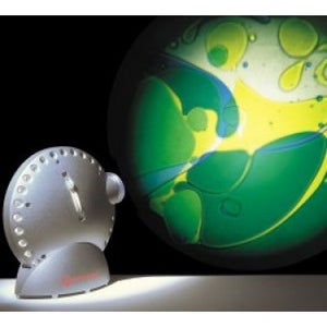

a motor, motors are in lots of things, for this project something small and slow,i used one from a mathmos projector complete with power supply and switch, the best value ones iv found on ebay go 60 rpm on 3 or 4 volts for about £2.50, check out my video on getting the motor out a hoover.
