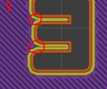

The tiny letters inside the front panel are something to pay attention to when slicing the part. One of the likely things to encounter is gaps inside some of the letters because of no inner perimeters. The first two pictures do show this. As always there's multiple ways.
One way is to use "gap fill" or whatever it might be called in your slicer. This may lead to more or less likeable results, pictures 3+4 do compare this from different slicers.
Another way is to simply lower the extrusion width until the slicer fits inner/outer parameters and doesn't leave any holes (pictures 5+6). But remember to have it at the proper values when the print reaches the upper part, the walls are multiples of 0.50mm.
Another thing that is tricky on shapes like this is the infill. Depending on extrusion width you will get some places where infill doesn't reach every spot. Increasing the perimeter overlap is often used here - I absolutely do not recommend that.
Instead use different fill angles to make sure there's no gaps left. Depending on your slicer you can simply add different infill angles (Cura, S3D) or might have to use modifiers (Slic3r/PS). Increasing/Decrasing the amount of perimeters on 2 layers additionally will also help in getting a nice closed surface around the letters.
