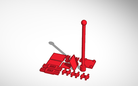

Step 1: Design
This is the file I designed myself on Tinkercad. Download the design model as an STL file.
